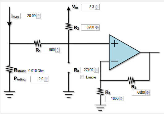

Following some guidelines for the configuration of the WB and hardware.
Step1 hardware configuration:
The configuration for the FOC - 1shunt driving with the STEVAL-SPIN3202 is:
Step2 MCWB configuration:
When you create the project selecting the STEVAL-SPIN3202 as target board, most of the parameters are already set, but you should verify the following:
