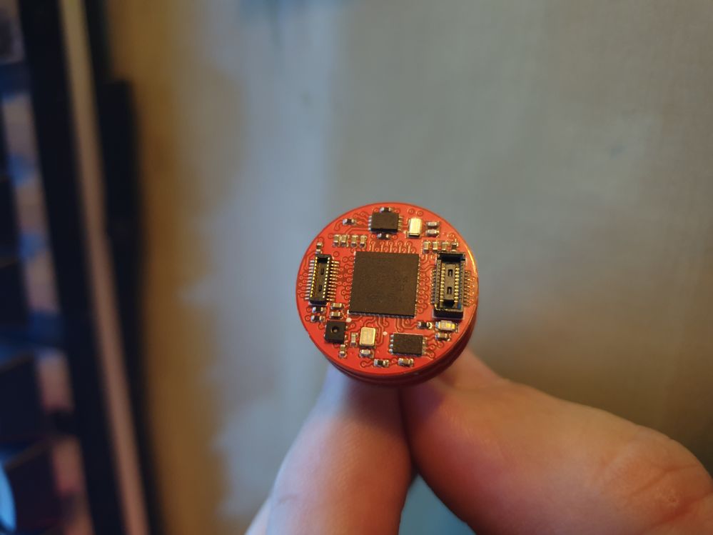

So, I have a custom board that has on it an STM32F411CCU6TR.
Initially i populated the entire PCB including several peripheral components. A sensor, an RTC and cryptographic security IC.

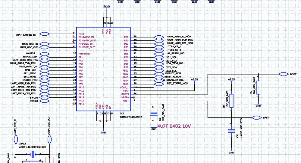

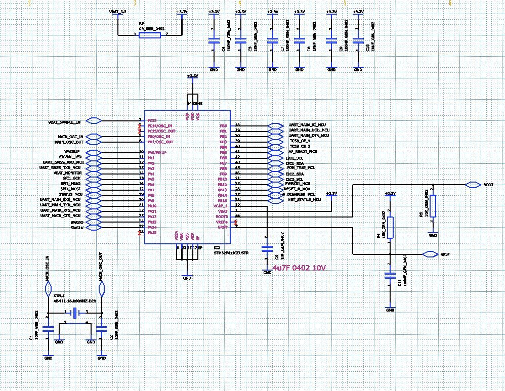

I have attached the STM32 schematic, The quality isnt great as the software i am using doesnt yet export to PDF. S i have added another one to clear it up so you can see the chips pin out better.
Also in the schematic it shows a 4.7uF 0402 cap for Vcap. Throughout the above debugging it has been swapped for a 10uF 0603 X5R.
All of the pinouts go to headers so on my bare populated PCB there all those pins are floating.
I am thinking that due to not properly understanding the STM32 that i have possibly used a pin for a task and its an important pin. But despite looking over and over i cant see where it would be.

VREF+ (VDDA) should be powered
2020-01-11 7:22 AM
Clive, You mate, are a legend. I left VREF+ disconnected since i wasnt using the ADC. Also from my experience of using PIC i have never needed to use it.
Connected VREF+ and it starts up and connects.

AN4488 section 2.2 point 3 says "VDDA pin must be connected" and figure 2 shows "Analog: RCs, PLL, ...". By RCs they mean RC oscillators - HSI and LSI. As after reset MCU starts from HSI, VDDA is absolutely necessary. Also, because of starting from HSI, crystal/oscillator is not required for a bare minimum and not required at all, if HSI tolerance is enough for your application. SPI, I2C and USART run as a charm from HSI based clock... =)
