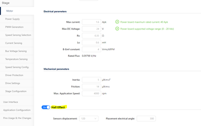

However, inside the MC Workbench I can only choose between the two observer option.
None of the hall options show up, neither as the main nor the auxiliary sensor (in this context they're greyed out and cannot be chosen).
There is no message as to why this is the case either.

Thanks, that worked!
So it depends on the motor configuration as well. Makes sense.

Even after selecting hall sensor option in motor section, iam unable to select hall sensor option in speed control , can anyone help me .
Iam using nucleo f030r8 with custom motor driver and a hall sensor based motor
