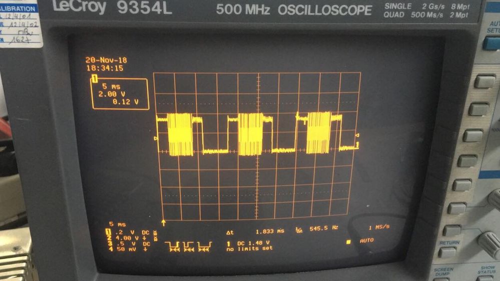

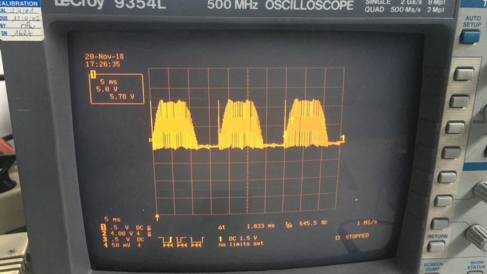

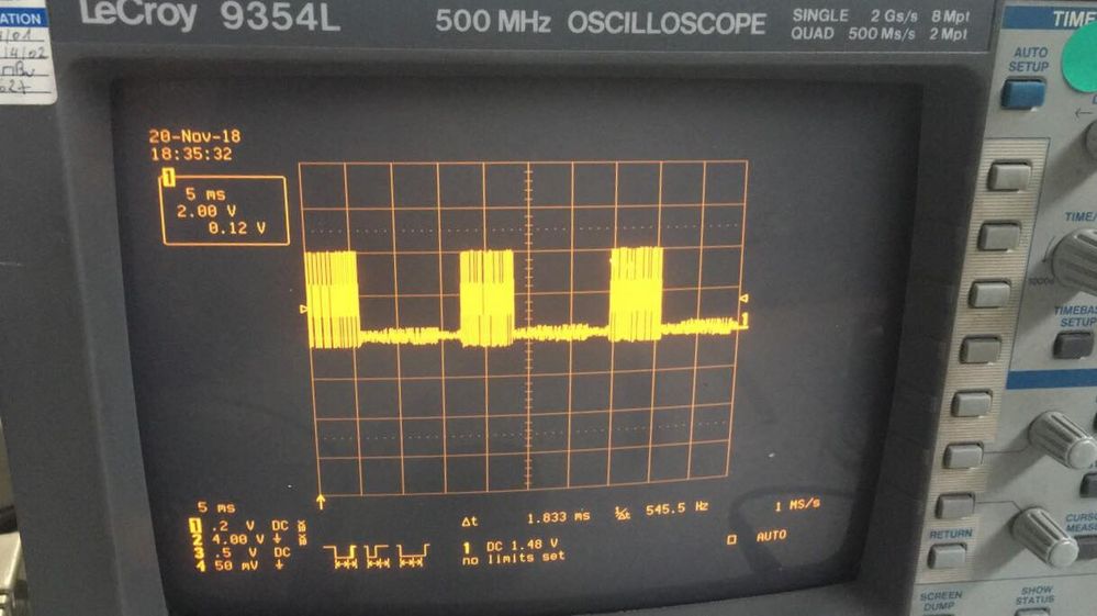

Ps: while spenning the motor with x-cube-spn8 binary file and using an oscilloscope I found the folowing signals:
1) on TIM1_CH1,2 and 3
2) on TIM1_CH1N,2N and 3N
3)on motor's outs
I really need your Help!
Thank you
