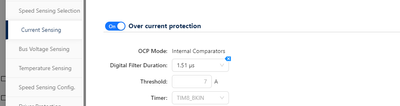

I've used the interface in MotorControl to create/configure the motor I want to use with my tests. Everything works fine until I push the start button in MotorPilot : I immediately get a FAULT_OVER / Over Current.

Can you increase the digital filter duration to minimize sensitivity to electrical perturbations?
If this is not sufficient, can you disable the Over Current protection? Driver protection will remain active to ensure board and motor protection.

I've been playing with the digital filter value and Over Current protection in order to get my motor spining.
Increasing digital filter value worked fine with the FOC control using hall sensors for speed control. But I was able to make it work with the Sensorless configuration and motor profiler only once I disabled the over current protection.
Thanks for helping me with that.
