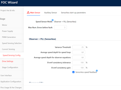

2024-10-29 6:04 PM
Thank you @Gael A for the thoughtful response. I spun up a new board with all current sensing on a single channel (ADC1). However, now I'm running into other issues:
Could this be related to my current ADC setup not being correct? This blocks me from saving new configs.
I've copy/pasted my Board Designer file and attached the MCWB project file. Could you possibly point me towards a dev kit using the STM32G431 with 3 external current sensor inputs and encoder input?

2024-10-30 4:21 AM
Hello shane mattner,
The reason why you cannot select the Encoder speed selection is because your board description lacks the "QuadratureEncoderRelative" feature. In fact, even if you will only use the absolute feature, the relative one is mandatory to allow proper generation. This is a limitation of the tool, we apologise for the inconvenience.
Concerning the reason why the WorkBench does not allow you to go further, it is because you have invalid gain values for G2. It seems the auto-calculation did not give a satisfactory result and ended up with an error. This is the same for your PI gains in Drive Settings. You can check the User Manual (Via WorkBench, you can find it by clicking on About -> Documentations -> Documentation -> in the newly open browser window, click on User Manual) to have more info on how G1 and G2 gains are calculated.
Please make sure that all constant values in your board are correct before simply overwriting the gain values by hand via WorkBench.
