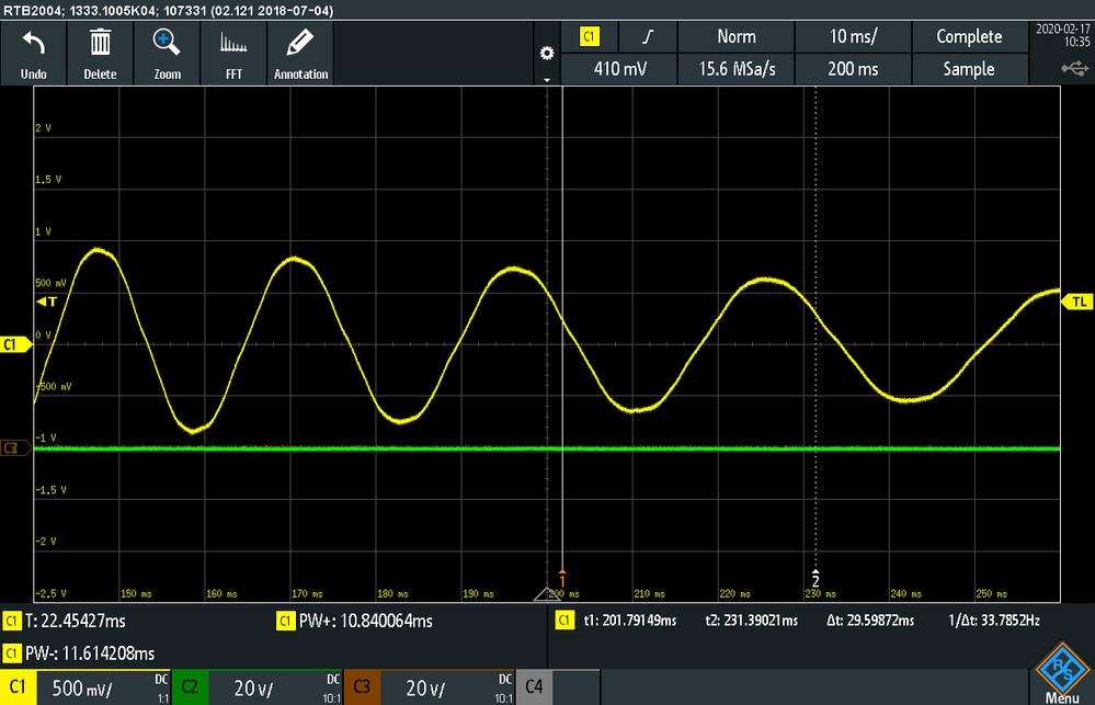

I was wrong, it must be an SM-PMSM motor. The waveform on the windings (if I spin the motor):
