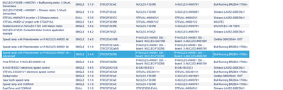

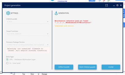

Here the steps that I have done,
1- I opened the "MotorControl Workbench 5.4.8" and selected some random example project, in this case speed ramp with Potentiometer on P-NUCLEO-IHM001 kit-- Advanced
2- I hit save as project and saved that in an empty folder named motorControl in win11 desktop
3- from the tools menu I clicked the generate button
4- in the opened dialog, I choose target tool chain to be keil v5 and I hit Update,
5- I would get this nasty error
Please check the attached pictures,
2024-01-31 2:11 AM
Hello @ali_dehbidi,

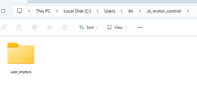

Could you check whether you have a wb2mx.properties file in your .st_motor_control folder located in your home directory ?
If it is the case, please remove it (or comment all the content)
Last remark, I highly encourage you to switch to MCSDK 6.2.1. The potentiometer example is now a built-in feature, no need to start from a custom example.

2024-01-31 4:46 AM - edited 2024-01-31 4:48 AM
You home directory is in your C:\Users\ folder, It should contain a directory named as your login name.
Inside this directory you should have a .st_motor_control directory containing a wb2mx.properties file.

2024-02-01 12:33 AM
Hi Cedric
thanks for the update, Please see my home folder content
There is no wb2mx.properties file, so the problem with V 5.4 remains, also v5.4 gives a lot more MCU selection, are you sure the new version would support 380 MCUs?
