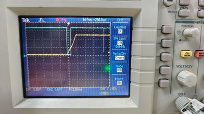

nFault is getting low for 1 ms and then high and after 10ms it again goes low for 25us and then high.
CH2 (Blue) is nFault and CH1 (Yellow) is REG12.

Hello riteshEDC,
Thank you for your reply.
Yes, this is indeed an intended behaviour. You can find in the STDRIVE101 datasheet that the nFAULT is brought to low during power up and wake-up sequence. The firmware needs to disable the Driver Protection check during that time.
