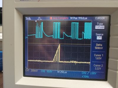

To get oscilliscope traces:

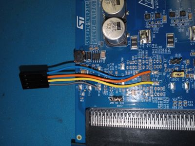

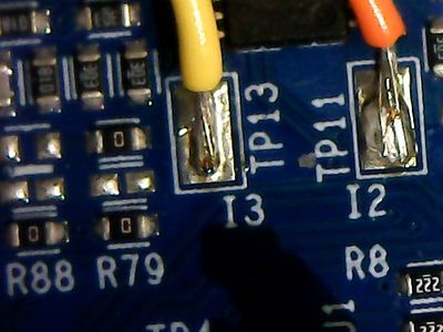

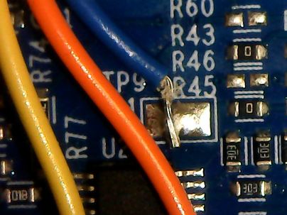

Current: I soldered leads onto TP9, TP11, TP13 (power board op-amp outputs). I read one of these at a time.

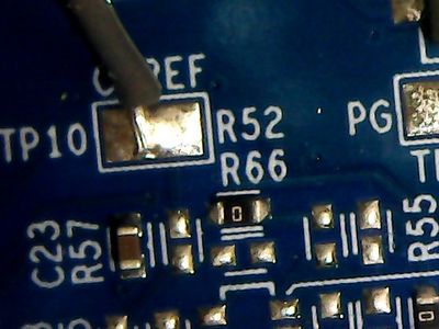

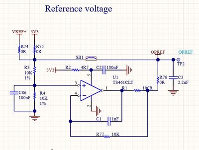

I tried using TP10 (op amp reference) as reference for oscilloscope measurement, but connecting my ground lead from my probe causes the processor board to crash, showing 2 red lights on the RGB LED's by the usb cord
Voltage: pulled directly from the Vout screw terminals.
My oscilloscope is set to record a single frame, triggered by a rising edge of the voltage going to the motor. I used software to monitor the button User2, entering speed control mode on press, and going to observer mode on release.
What I expect to see: gradual current ramp up (+- Pulse current goal), down, up reverse direction, and back to resting point, as shown in HSO startup guide.
What I see: Chopped ramp current up to less than goal, and abrubt drop to zero current. I only see current in one direction.

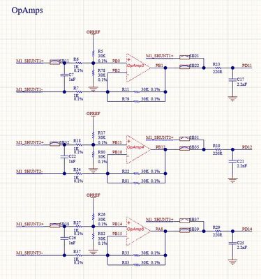

Amplifier gain (from schematic) g = 15k Ohm / 1k Ohm = 15
Shunt Resistiance: 0.015 Ohm
Peak current: (Vp / g) / R = 2.59A

Concerning your oscilloscope issue, I fear you may have created a short-circuit while soldering the leads on test points

I checked my solder job, and don't see any shorts. (pics below) I did check the probe on my oscilloscope, and it does connect directly to the power ground, so if signal ground isn't isolated from power ground on the power board, that would explain the crash on using ORef as my oscilloscope reference.

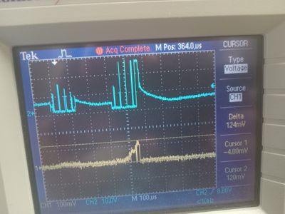

I thought shorting ORef may have damaged my power board op-amps These op-amps are not used by the code, as I use the internal op-amps on the processor board. I used the circuit to trace internal op-amp outputs (prefiltered) to SB35, SB39, and SB22. Putting my probe on these points, I was able to get a waveform similar to the one I had from the other points, minus the chopping on the ramp up. (Pic below)
I tried a pulse duration of 4 with a current goal of 6A, and decay time of 1. It doesn't replicate the .83 duty cycle you report. It shows -0.98 PulseDuty in red, so I am guessing I am saturating the pulse output. I am running 24V supply. What voltage did you run yours at?
The motor still shows the same problematic behavior. I show a single up ramp on the op-amp output to 124mv, and an immediate drop to 0v. This suggests an output current of about 0.5A, much less than the 6A current goal given on PolPulse Params

While the actual current on a phase is continuous, the shunt signal is 'chopped' as you say. The signal is only present when the relevant low side FET is on. I assume the HSO startup guide image was captured using an external current probe.

Opref must not be connected to GND because it is the biasing to Vref/2 of the OPAMPS for measuring the current in the shunts in both direction. Setting this point to GND will probably not break the OPAMPS but risks to break the power stage depending on the reaction of the algorithm.
