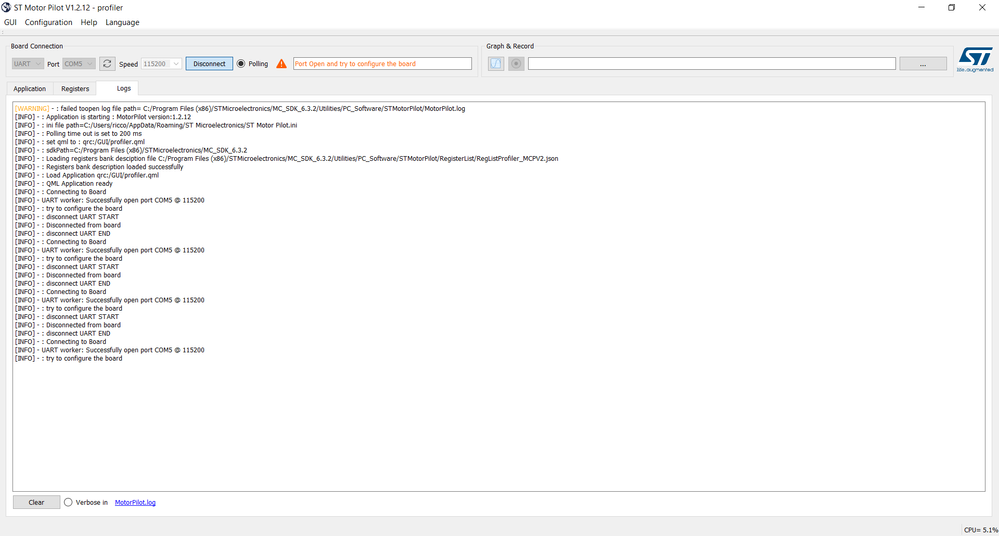

Unfortunately, I faced an error of "Port Open and try to configure the board and I'm stuck here. It's a very similar problem with this discussion :

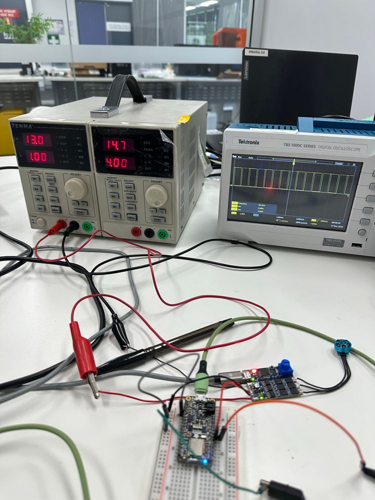

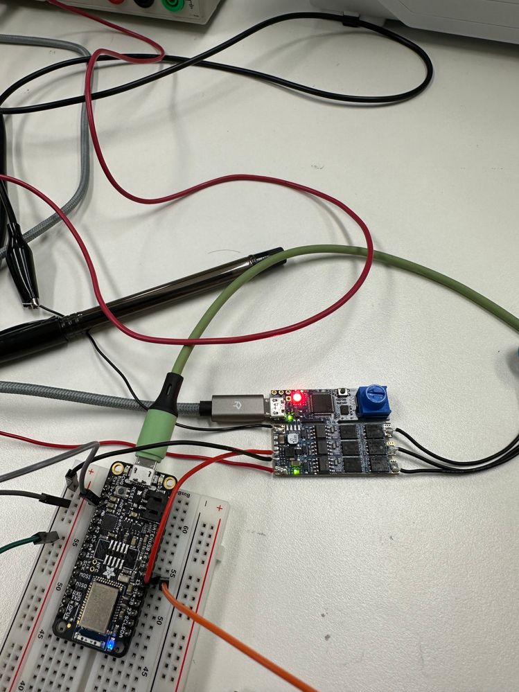

-. So I have already connected the V+ and V- (3S Voltage - I'm interested in) to a power supply and also the PWM and GND to an external microcontroller (an Arduino setup generating 490Hz PWM).

-. PORT can be successfully opened with 115200 baud rate
I'm assuming the ESC is as easy as setting them up like that and Motor Pilot will just start profiling my motor, but am I still missing something of configuring the board?

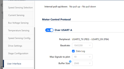

By default, on Motor Pilot 6.3.2, used baudrate is 1843200.
2024-12-16 4:30 PM

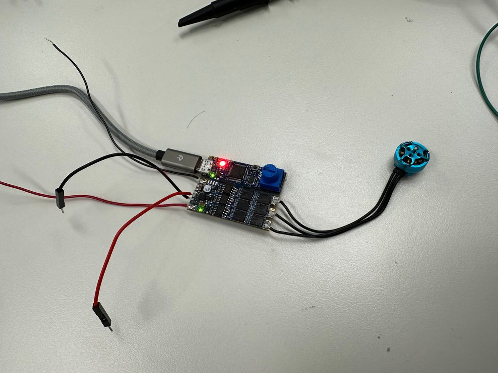

I still face the same issue even after changing the baud rate, setup at +13V. I attached images of my setup. Could you tell what's wrong with it? I think I'm doing minimum setup just to get it working..

It seems that you have 2 boards connected to your PC, did you choose the correct Port COM on Motor Pilot?
Sound strange that in idle B-G431B-ESC1 consumption is equal to 1A, idle current should be 0.03A...
Once B-G431B-ESC1 firmware flashed through the STM32CubeProgrammer, did you push the reset button?
At this point, did you try, after disconnecting the other board, to launch Potor Pilot V1.2.12 and click on "Discover Board"?

I'm trying to run this motor :

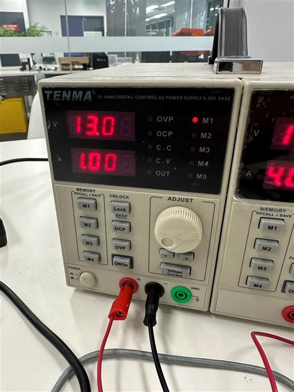

First of all, I see 1A on your power supply photo. Are you sure you are not hitting the Over Current Protection (OCP) value of your power supply?

On the project screen (see screenshot):
-Change Power supply VDC to match the setup (13V)
-Change PWM generation to 16 kHz
-In Application configuration, enable Motor Profiler
-Save and generate the project

This is the motor I'm trying to run for test (i'm testing a custom propeller for my use case but the screenshots are references from mainstream propeller) :
