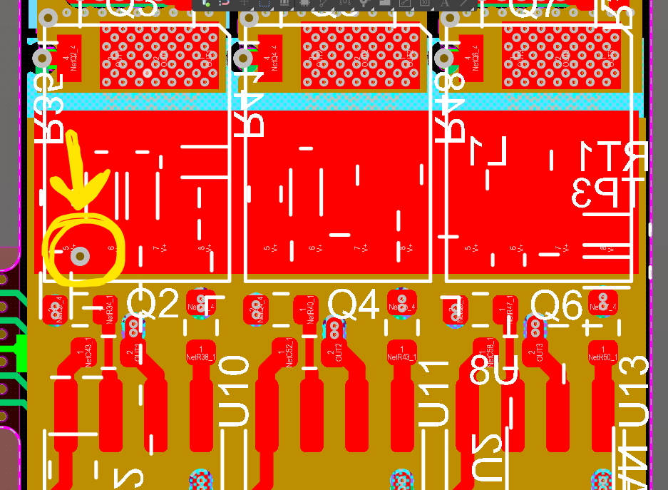

I have had a look over the B-G431B-ESC1 Layout Files and found that the High Side FETs are connected to V+ with a single Via.
The brown layer is V+, the large red pad is where the FET Drain is connected.
I can only see the single via i marked. The production files state the same.
This via can only carry about 1A of current, so this is definitely a design flaw.
Can you please check if there is a error in the design files I downloaded or if I am right.

Dear @FKL ,
thanks for your feedback. We are going to fix it and we will produce a new batch of the board soon.

The via you are pointing to is the connection of R68 to V+, who senses the bus voltages to VBUS.
But I also need to check where the other vias are.

It looks like that via is the only connection from V+ to the FET Pads.
2021-02-09 1:36 AM
Thank you Peter.
Is there any news about this yet? Did you find internal data about the board, maybe only the public download files are incorrect/not up to date.

Dear @FKL
Could you give me the link of the layout documentation you referred in order to check consistency with internal ones?
Best regards
Laurent Ca...
2021-02-09 2:15 AM
Hi Laurent,
I downloaded the Altium Project files as well as the Gerber production files from this link:
https://www.st.com/en/evaluation-tools/b-g431b-esc1.html#cad-resources
There has been a new revision since I opened this thread but I checked and the 'error' is still in there ;)
Regards, Frieder

Dear @FKL ,

@Giuseppe Scuderi_O could you please clarify if this an issue limits the max motor current ( for the board revision sold until end of Jan 2021).
br
daniele
2021-03-15 1:38 AM
you can use it at full load without issues.
BR
G.
