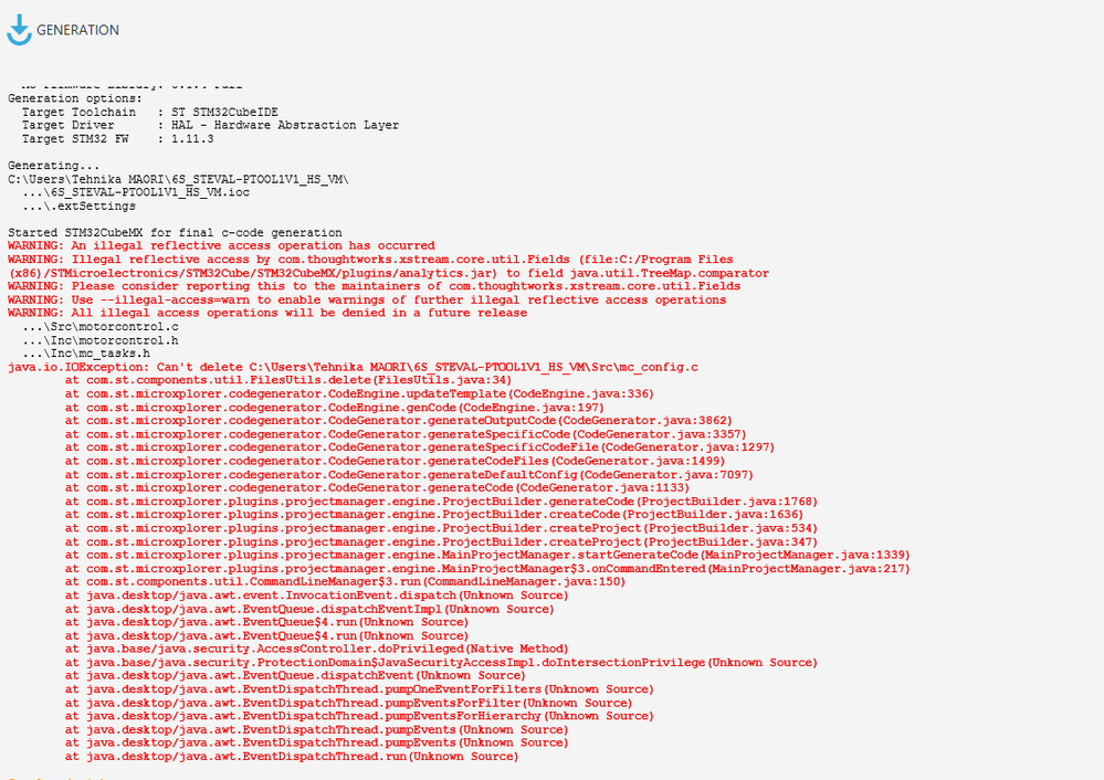

It is possible the framework can't correctly handle a space in the path.
It says it can't delete a file. Go see if you can or if something is holding it open.
