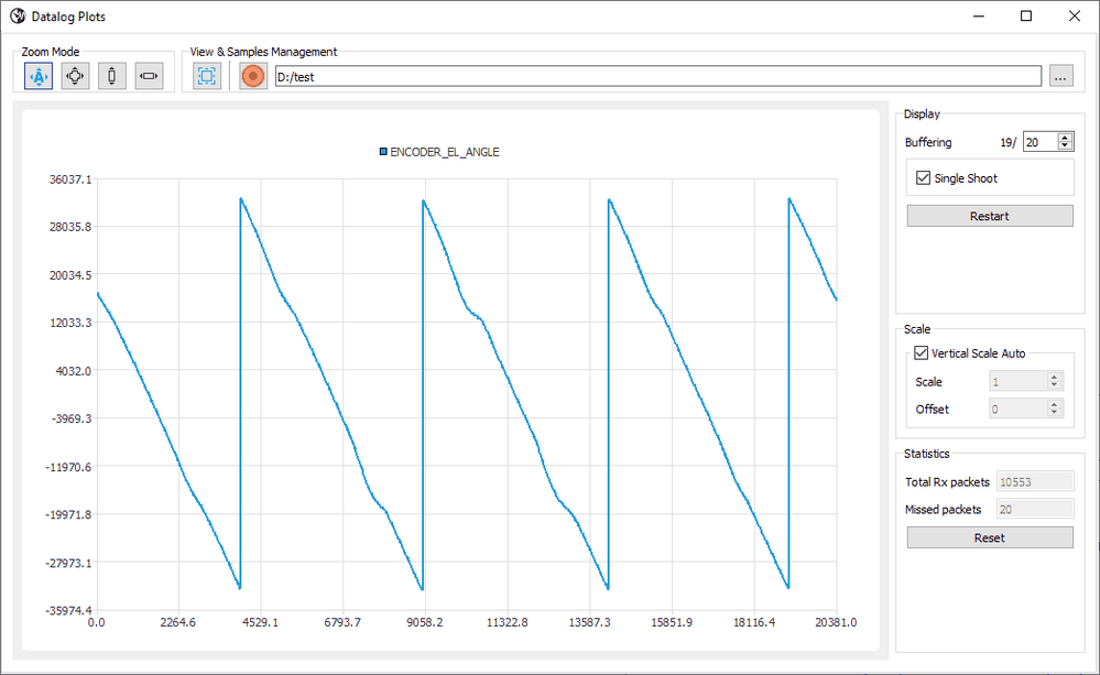

One way to test encoder:
- In motor pilot change mode to torque and torque reference to 0 and plot from ASYNC config tab encoder_el_angle when rotating motor slowly using other motor
(status should be run)
- If motor has 7 pole pairs then there should be 7 transitions in plot in one turn. This is easier to see when plotted from registers tab and rotating by hand (low sample rate).

Thank you @erno.1 for quick response, once I saw your snapshot I realized I'm using an older version of the motor control workbench, however even after updating the software and doing all the steps from scratch on a new project I was still getting the same behavior.
fyi, I was able to get the encoder graph by just plotting encoder_el_angle under torque control mode as you suggested but the motr doesn't respont to any positive torque command or velocity command. it just gets stuck, I tried the same thing with a new PCB thinking maybe I have mistakenly damaged the board but the behavior was the same.
