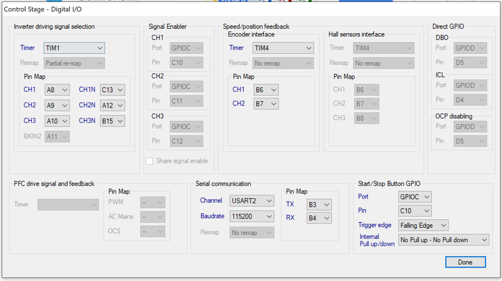

2021-06-18 2:47 AM
Motor control workbench -> Digital I/O -> Encoder interface -> Timer= TIM4 CH1=B6 CH2=B7

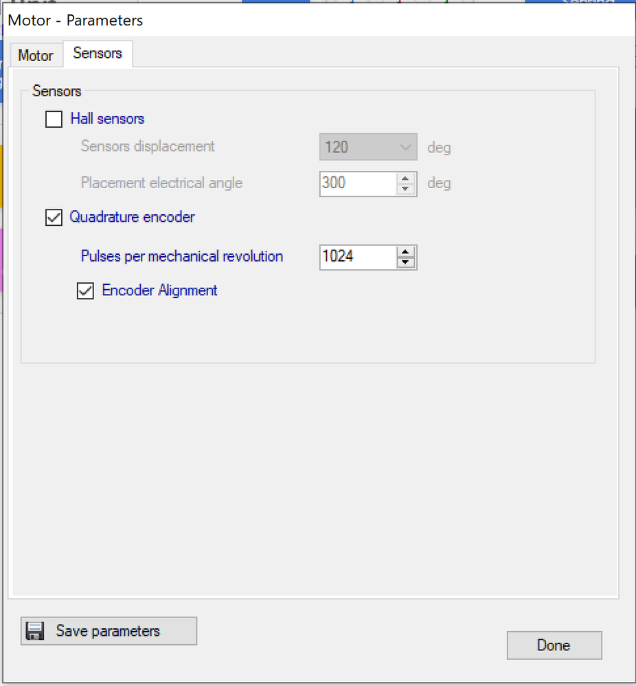

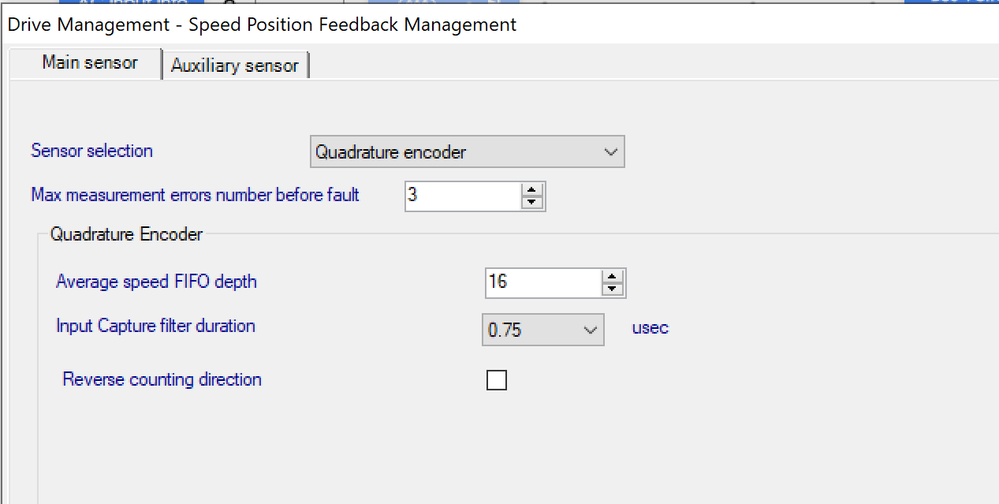

I am having a Similar problem and I hope someone could help as I don't even know how to debug my issue.
I have taken all the steps above and I'm trying to run speed control loop but as I try to do speed control with quadrature encoder rather than sensor-less mode, the motor doesn't turn. it makes some constant noise and it doesn't move at all.

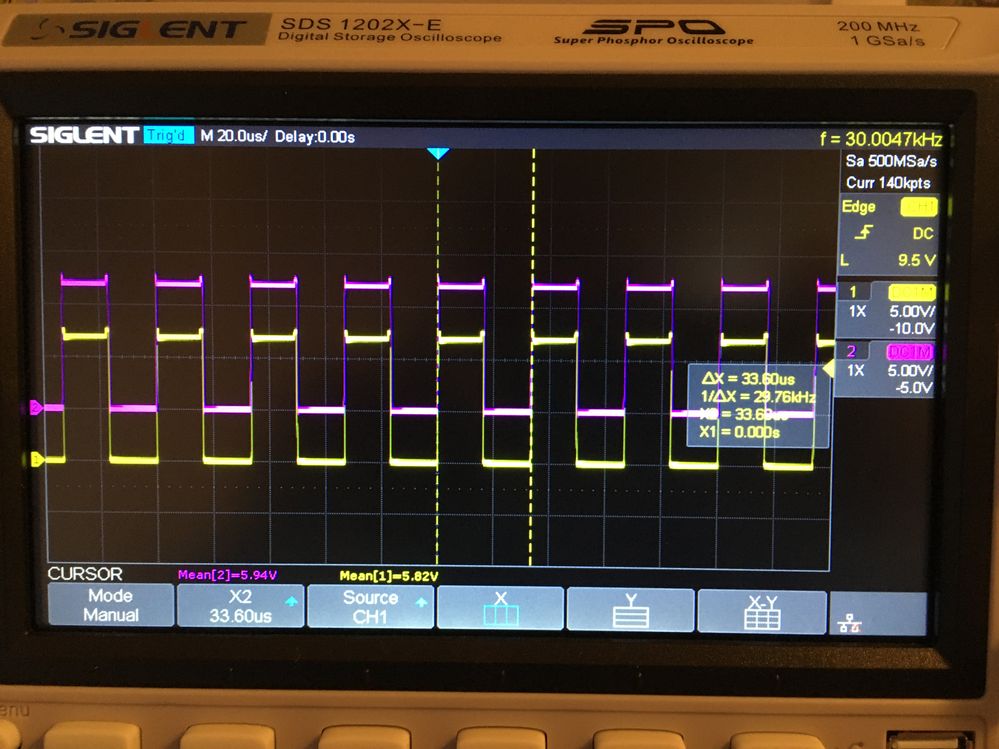

the same experiment works if I change the speed sensing block's properties to sensor-less but if I choose quadrature encoder it just makes some noise and no motion. I have tested the encoder and all signals look correct on the scope. When I turn the motor by hand I can see under "Measured Speed" that it is being measured correctly.
Here are some screenshots of my settings
Any advice is greatly appreciated.
2021-06-23 1:43 AM
Have you tried to switch encoder A and B wires?
Encoder rotation direction should match motor rotation direction.
2021-06-23 7:23 PM
I have, In fact even if I remove the encoder wires the behavior is the same, which is very strange.
