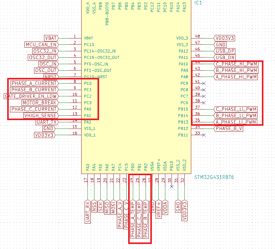

I have developed a custom control board and a custom power board. I am trying to add them to MotorControl Workbench 6.1.1 and I have written a custom JSON files describing both board. A few interesting things:
I am using STM32G431RBT6 as my MCU, the NCP51820 is gate driver and the current is measured with ACS772ECB hall effect current measurement IC. And the this is how it is connected to the MCU, most important connections are marked in red.

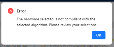

I am getting
Error
2024-01-02 12:42 AM
Hello Dimitar Dyakov,
As you are using a hall effect current measurement IC, the correct type for current sensing would be TwoICSCurrents.

To complete Gael's answer, the selected hardware variant for current sensing: ThreeShunt_RawCurrents_SingleEnded is dedicated to sense non amplified current and making use of internal Opamp to do the amplification internally.
Our implementation with hall effect current measurement makes use of only 2 phases. That's why so far, we propose only TwoICSCurrents.

Was the wrong choice of current measurement the reason for getting the "The hardware selected is not compliant with the selected algorithm. Please review your selections." error ?
