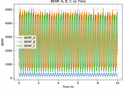

No progress made so far on the current sensing ADCs but I shifted focus to the BEMF ADCs. I disconnected R60, R62 and R63 from the driver shield and now they all seem to exhibit some behaviour when I spin the motor by hand. I believe currently two of them are correct, PC4 and PC5, after all conversion they read ~0.66V which is what I verified as correct with the multimeter when the motor is not moving, however, PC3 reads ~0.06V at this time. Also when I turn my power supply on the PC3 value changes like the others do but is static and won't change as I spin the motor by hand.
It's worth noting the differences in setup between PC4, PC5 and PC3. PC4 and PC4 are on ADC2, configured as 14bits with a 2 bit left bit shift. PC3 is configured on ADC3 which has max resolution of 12bits. I selected for it to have a 4 bit left shift so I could do the same conversion as the others however applying any left bit shift I noticed doesn't change the raw ADC value.

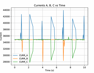

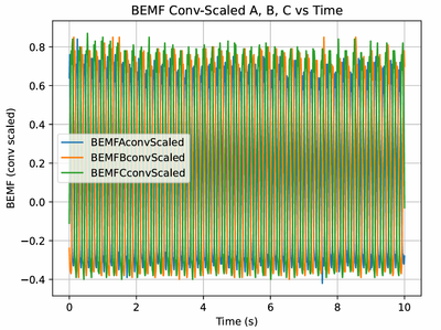

I've moved on from trying to configure adc3 with the bitshift. I've scaled them all differently and applied an offset value to line up 0 with the floating disconnected value. I'm not sure if this is the correct approach as you can see in the BEMF converted figure, what I believe is a phase-neutral measurement now has some negative value because of the offset, I'm not sure if this is acceptable or not.
@GMA mentioned validating the measurements with a scope. I noticed that when I spun the motor with a hand drill, the ADC pin would measure (with an oscilloscope) a 0.4V p-p reading whereas in software it would be ~1V, I'm not sure if my conversion is wrong, I am just doing a simple voltage divider calculation between R39 and R36.
Additionally, I had a question about converting the current sensing adcs, I was able to get the following data in the currents, A, B, C figure but am unsure of how to convert this into meaningful data.
Lastly, I had a question regarding the timing of the logic for my control loop. I want to configure to main loops, one for current control and 1 for speed control, with theouter current loop ~10x faster, i.e. current loop 10kHz, speed loop 1kHz. My initial idea was to create a timer interrupt that calls the relevant functions at these fixed frequencies but I'm not sure if it's appropriate to have that level of computation in the ISR, I don't believe the stm is capable of handling that without blocking. If anyone has ideas of a cleaner/better way to get this desired behaviour I'd greatly appreciate it.
