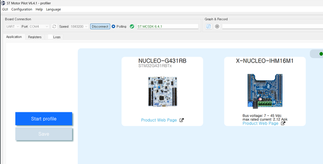

I am using Motor Pilot 6.4.1 Profiler and noticed that there is no "Start Hall Profiling" option available.
Could you please confirm if this feature has been removed or if it is located elsewhere?

Hello @pelino,
Feature is available enabling HALL sensor as auxiliary sensor.
Refer to 5. Hall sensor profiling with the Motor Profiler tool chapter of the Motor Profiler Application Note document available through "Workbench tool">About>Documentations>Documentation>"User manual" tab.

The Start Hall Profiling option comes when the profiling (Start Profile) is successful.
