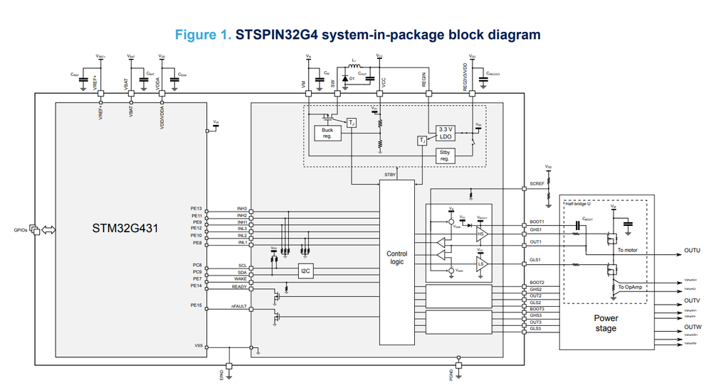

I have added here a picture of the EVSPIN32G4 chip. This is the block diagram. Can you tell me how I can match the list of pins I sent you to the block diagram?

If you are using an EVSPIN32G4 board, then the configuration of the MCSDK follows the schematic of the board and allow you to select all the alternative configurations possible from your hardware. You mentioned that "In the software it is not set up the way I need it."
Does it mean that the generated software does not work as expected?
What is your actual need?
You are talking about pins that are not part of our eco-system, so it is very tough for us to answer correctly.
GND Ground wire : Are you looking for the ground of the EVSPIN32G4 board ?
What is F/R Forward and reverse? We do FOC control, the direction of the motor is defined by the PWM duty cycle applied on the 3 phases, there is no pin used for selecting the direction.
What is SV Analog input ? Do you want to use single shunt or three-shunt config? By Analog input do you mean ADC input or OPAMP or comparator input?
EN Start Stop : It looks like the Pin PC13 if you look at the table below
BK Brake Control : This board uses internal comparator to do over current protection, internally connected to break input.
PG Speed pulse signal output ? I do not know what this signal is.
Here is the list of all signals we use on the STSPIN32G4 when mounted on a EVSPIN32G4 board.
