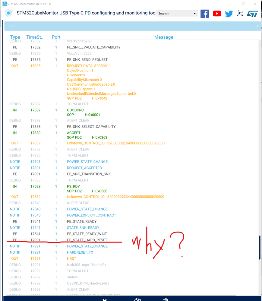

I am developing an X-CUBE-USB-PD system that works with the STM32G070CB and FUSB307B.
It is based on an example project for the FUSB307BGEVB, which behaves as a DRP.
The library I'm using for it is M0_PD3_FULL.
It works fine in most cases, but there is one problem.
When acting as a sink, PE will send a HardReset about 450ms after Explicit Contract.
What could be the reason for the state transition from PE_STATE_READY_WAIT to PE_STATE_HARD_RESET?

Hi
Now, I understand your setup. Could you check if you have correctly enabled CRC block on G0 side? If no, please enable it.

2020-07-01 7:11 AM
hi Yohann
I enabled the CRC unit.
After that, no more unexpected hard resets were sent from the MCU.
I wasn't aware that CRC was needed for the X-CUBE-USB-PD.
Thank you so much.
