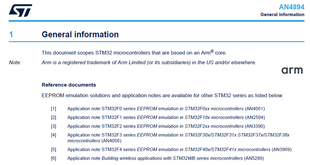

It's not mentioned in the Databrief or AN4894 or elsewhere
https://www.st.com/en/embedded-software/x-cube-eeprom.html
So it's AN4061 instead ?

Hello @Andrew Neil
As you can see on the AN4894 or the Databrief, The X-CUBE-EEPROM doesn't support the STM32F0 series. So, the best guide will be the AN4061as you already said.

@STTwo-32 wrote:Hello @Andrew Neil
Oh yes - so it does!
So X-CUBE-EEPROM also does not support:
