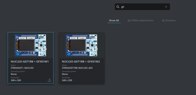

TouchGFX is usable with the STM32G071RB, we even have a couple of TBS for it :
You will definitely be limited with such board but it is possible to use TouchGFX, we just recommend to not use any RTOS.

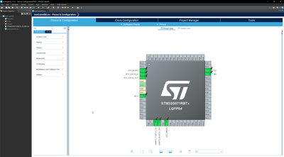

For instance, here is a brand new STM32G071RB project created using STM32CubeIDE, but as I create the project, it embeds STM32CubeMX:
In this project, I am not able to enable X-CUBE-DISPLAY, but if I create a STM32G071RB project from STM32CubeMX, it is also not compatible with my version but it is compatible with older versions of STM32CubeMX that are available for download on the official webpage.
Also, have screenshots and maybe the project file could help us.
