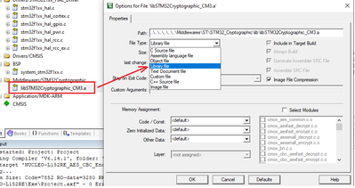

Yes. I reproduced the behavior.
You need to select "Library file" instead of "Assembly language .." in this menu:
Right click on the library and select "Library file"

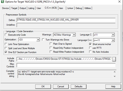

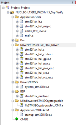

I suggest you to see how a project from Projects\NUCLEO-L152RE is constructed to inspire from it.
You need at least to have something like this:
Don't forget to define the include paths and the defines here:

2024-02-22 10:25 AM
2024-02-23 2:47 AM
Yes, this helped!
For the first selection, a library .a file only could be taken as asm file. Change to library file, could build in the crypto library in my project.
