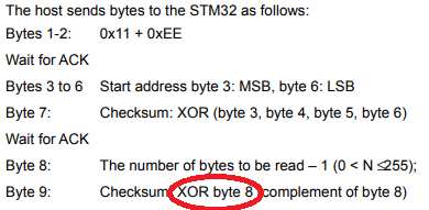

I'm using an STM32F103 and flashing a code into it using the bootloader. I'm successful in writing the code into the MCU, but when I try reading it using the Read Memory command (pg13) [
] it fails at step 6 (Send the number of bytes to be read (1 byte) & a checksum (1 byte).) I receive a NACK. It's confusing here, so I tried sending both XOR of 8th byte with 0 and in the next try tried sending complement of 8th byte, both failed.Here's what I'm doing:

What should I say. The current specification AN3155 doesn't work with a STMF103C8 for the Read Memory Command. It takes me one day to find a solution for this error.
AN3155
If you take Byte 8 (127) and make a XOR of Byte 8 (127) for Byte 9, you will get a NACK.
If you take Byte 8 (127) and make a XOR of Byte 8 +1 (128) for Byte 9, you will get an OK.
I found this solution by sniffing the communication of the old program "Flash Loader Demo".
But this is only for the Read Memory Command and there only for Byte 9!

I think I have figured this out as I was having the same issue. The key is the wording in AN3155:
"Checksum: XOR byte 8 (complement of byte 8)"
It actually means that the second byte is the complement of the first byte. In C, this would be the ~ operator. This is the same as the command byte.
Example 1:
Byte 0 = 0x01 (Read 2 bytes)
Byte 1 = 0xFE
Example 2:
Byte 0 = 0x7F (Read 128 byte)
Byte 1 = 0x80
