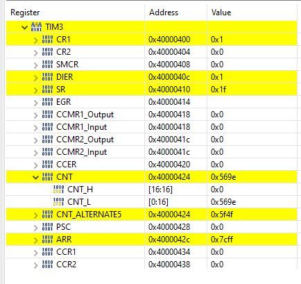

The issue with this is that if the timer rolled over with the interrupt off, we would lose that tick count as the timer never stopped. We want to use the timer disable/enable to stop the timer, grab the counter and restart the timer exactly where we stopped it. Is there a document that can verify that when we restart the timer it does not reset the counter register Timer3->CNT?

I like the code you wrote but you are doing three 64bit reads (at least two clock cycles each) and a 64 bit wide compare. A single register write(disable), 64bit read and single register write(enable) is faster. I can't say how many timer3 clock cycles I would lose as I'm not proficient in ARM assembly, but it's somewhere in the 32-48nsec range for each read of the timer value if the disable/enable does not reset the timer3 count. If the timer were critical I would use your method or maybe go with a 32bit value which are single cycle reads and deal with roll overs, but losing a few nsec in our use case has no bearing.
