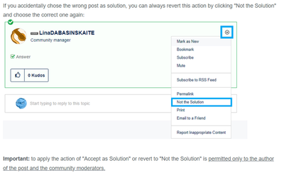

2025-01-15 2:35 AM
Hi @Imen.D
sorry, i accidentially hit the resolve button.

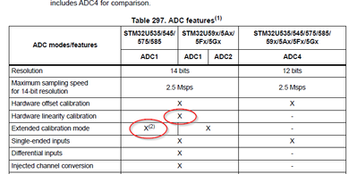

I have a U585 Rev x device. As I do not use the extendend calibration this sould be no problem right?
Or is the ADC_CR_CALLIN bit only for extended calibration and not for the simple "Hardware linearity calibration" ?
Thanks in advance

2025-01-15 6:21 AM
I removed the "Accept Solution".
Help others to solve their issues - STMicroelectronics Community

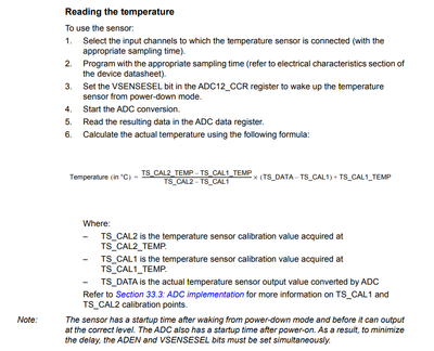

Please have a look at the reference manual which describes how to read the temperature of the internal temperature sensor.
Maybe you have the same issue described in this post:
Solved: STM32U575 Temperature Sensor ADC4 calculation - STMicroelectronics Community
2025-01-19 10:12 PM
Hi @Imen.D ,
thank you for the hint about ADC4 and temperature measurement. But that is not our Problem, we already respected this.

Is the ADC_CR_CALLIN bit only for extended calibration and not for the simple "Hardware linearity calibration" ?
Or is the "Harware linearity calibration" part of the "normal" calibration when I simply set ADC_CR_ADCAL.
Thanks again
