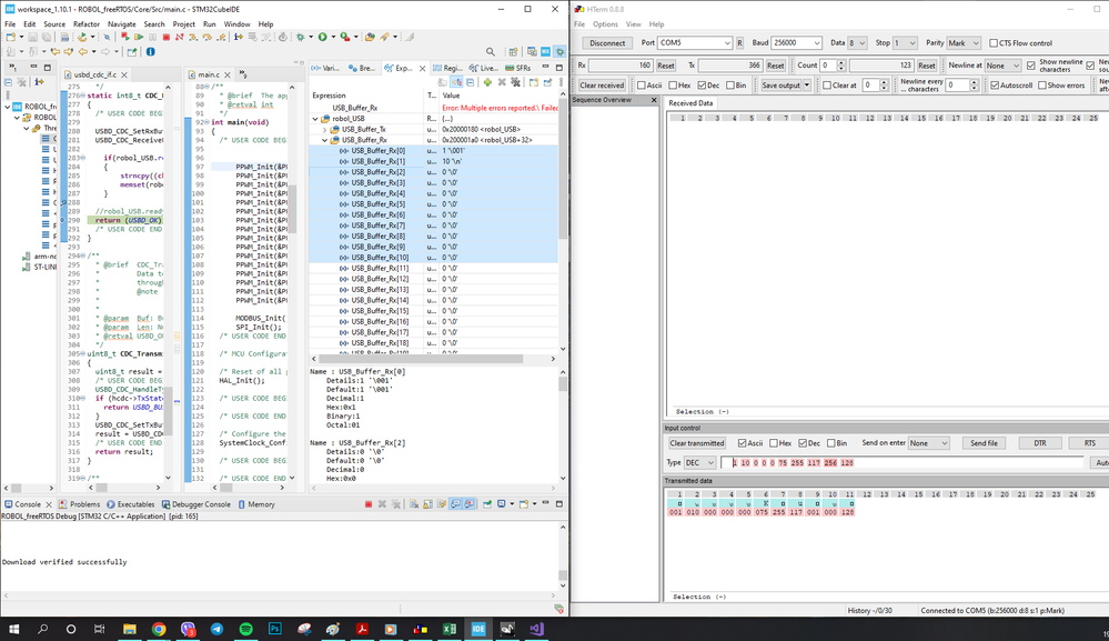

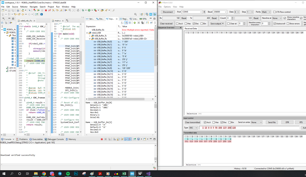

I have created project USB Virtual Com Device on STM 32F407. I set size of parcel = 32 byte. When i send parcel and befor parcel ends byte will be "0" STM 32 don't read bytes after "0". If no "0" byte always is OK. What doe's it mean? How get full parcel with "0" bytes inside parcel?
2022-11-20 7:43 AM
On your screenshot, line 285: is this a strncpy?
Do not use string functions on raw (binary) data.

That is, it turns out that I cannot send the DEC array = {1, 10, 0, 0, 0, 75, 255, 117 , 256, 128}.
Will I have to reformat the array to a char? So this will increase the size of my package. How then to define "0"?

2022-11-21 2:01 AM
memcpy solved the problem, thanks a lot
