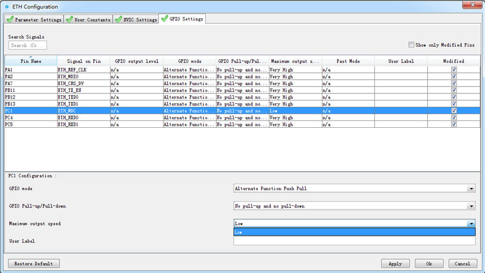

I using cubemx to config stm32h743 eth, why pc1 can not set output speed to very high, the pc1 can only select low, not like other pins.
Thanks.
#stm32h7-ethernet2018-07-01 8:00 AM
Doesn't MDC clock at 2.5 MHz max, what would be the value of aggressively slewing it other than generating unnecessary ringing and noise?
