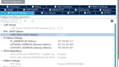

Step2: Then I have configured the Cubemx based on it
cubemx config

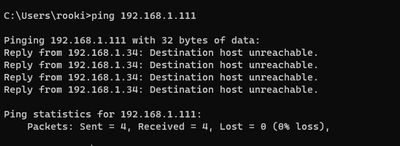

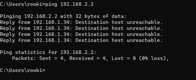

Cmd output for Ping:
(The response to ping is from a different IP address, and why is that?)

If the mask on your PC is 255.255.255.0, 192.168.2.2 masked by that mask (i.e. 192.168.2.xxx) does not match the network on which the PC is on (i.e. its IP masked, i.e. 192.168.1.xxx), which means, that the network stack tries to use the gateway to route the ping (assuming it to be directed to some external network). It then boils down to the details of your whole network why the reply is from a surprising IP address.
In other words, STM32 needs to have a 192.168.1.xxx address to be accessible directly by the ping.
Do some reading on addressing in the Internet Protocol.

Output:
I am wondering, if I missed something on the settings essential to network stack.
2024-01-03 6:06 AM
Maybe the link layer does not work as expected. Debug as usually, start perhaps by observing your gnetif struct.
