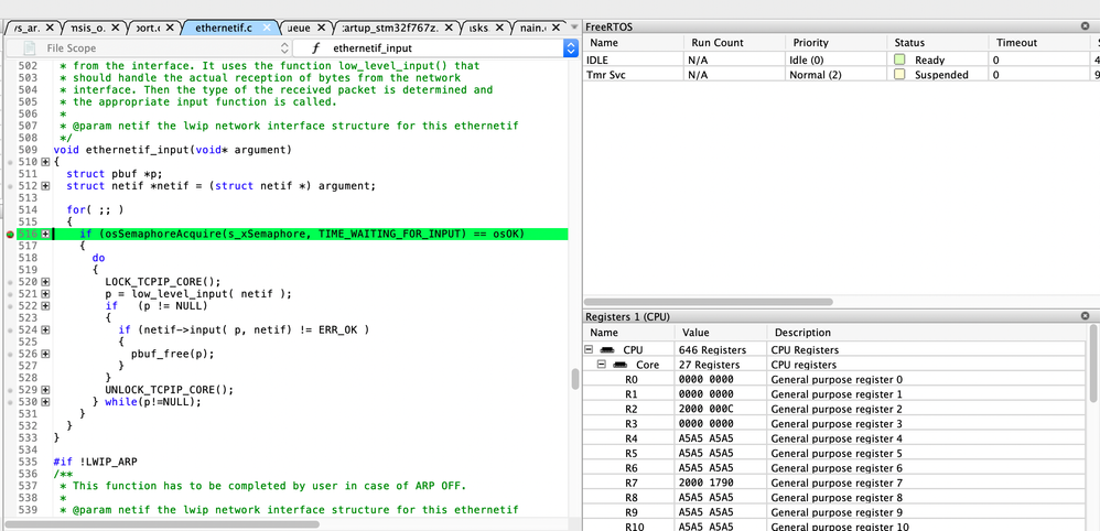

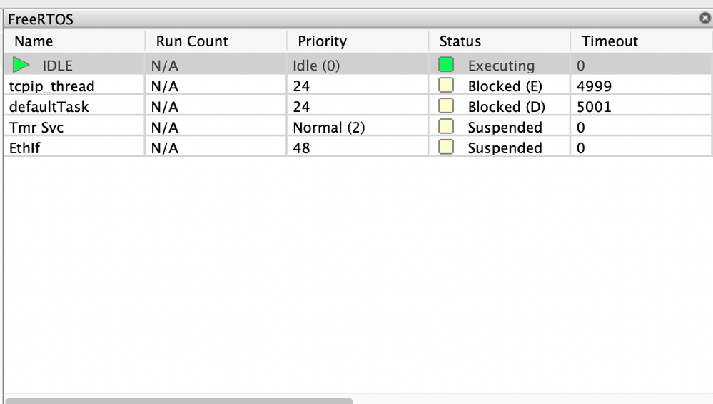

I started debugging now with Ozone. My Led task is not visible anymore after the device crashes, and the mcu seems to cycle in this function:
void ethernetif_input(void* argument)
struct pbuf *p;
struct netif *netif = (struct netif *) argument;
for( ;; )
if (osSemaphoreAcquire(s_xSemaphore, TIME_WAITING_FOR_INPUT) == osOK)
do
LOCK_TCPIP_CORE();
p = low_level_input( netif );
if (p != NULL)
if (netif->input( p, netif) != ERR_OK )
pbuf_free(p);
UNLOCK_TCPIP_CORE();
} while(p!=NULL);
}it stays within the for( ;; ) . The only tasks left in the taskview are idle and tmr svc.
