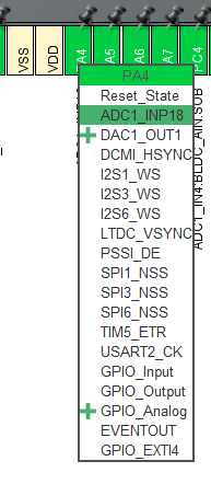

The signal is connected to PA4, evaluated by ADC1CH18, no PU, no PD.
Furthermore, we are using the temp channel of ADC2.
We use CubeMX for configuration, version 1.10.

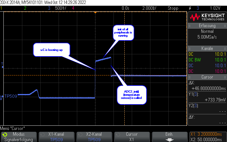

During initialization, everything is fine, the signal has something around 1.78V. As soon as ADC2 is initialized, the PA4 pin will be pulled down to 0.7V. This is not expected behavior, as PA4 is not connected to ADC2 in any way and the input impedance should way higher than ~2k.
We can reproduce this bahaviour with serveral PCBA. Furthermore, we unsoldered the package pin,and voltage divider was fine. Same bahavior after deleting flash of uC.

debugged step-by-step. The problem occures as soonas the temp channel of ADC2 gets configured:
adc.c
//start line 268
/** Configure Regular Channel
sConfig.Channel = ADC_CHANNEL_TEMPSENSOR;
sConfig.Rank = ADC_REGULAR_RANK_8;
sConfig.SamplingTime = ADC_SAMPLETIME_16CYCLES_5;
if (HAL_ADC_ConfigChannel(&hadc2, &sConfig) != HAL_OK)
Error_Handler();
}HAL_ADC_ConfigChannel is called inside stm32htxx_hal_a, there in line 2900:
//start line is 2900
hadc->Instance->PCSEL |= (1UL << (__LL_ADC_CHANNEL_TO_DECIMAL_NB((uint32_t)sConfig->Channel) & 0x1FUL));afterwards, voltage level is 0.7V.
I added the cube *.ioc which was used to reproduce the same behavior, after ADC2_Init(); pin is 0.7V.

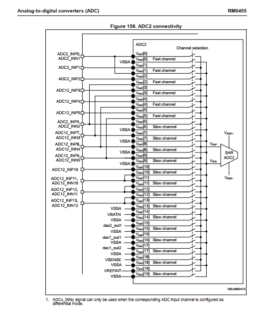

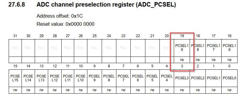

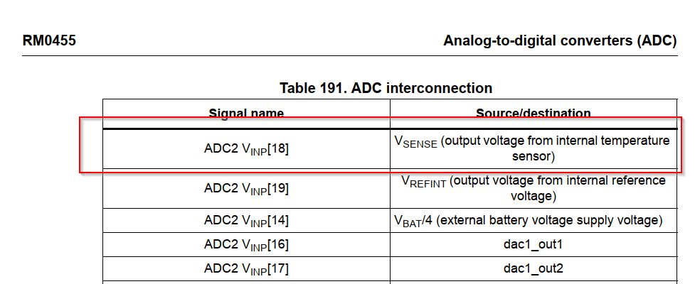

so PCSEL19 of ADC2 is written... seems not ok to me, as this is the Vref_sense of ADC2 (which is actually enabled for adc2, too but is set in some lines before) voltage and not the internal Vsense for temperature sensor signal. Could someone confirm this behavior?
2022-10-13 5:20 AM
0xc4207 - 0x84207 = 0x40000 and that's bit 18, so that's indeed the temperature sensor, not VREFINT. Bit 19 was already set before line in question (although IMO that shouldn't be a requirement either).
Nonetheless, IMO the temperature sensor should never be connected to the external pin, and marking of PA4 in DS indicates that it should be connected only to ADC1_INP18 not to ADC2_INP18.
@Amel NASRI , can you please have a look at this? It appears to be a candidate for an erratum.
Also, if the temperature sensor subchapter is correct, software - thus Cube - should not set ADC2_PCSEL.PCSEL18 bit at all.
