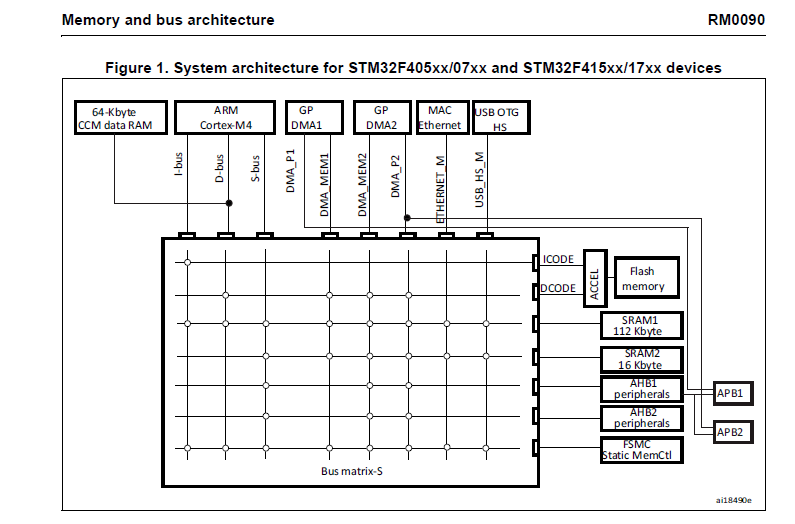

Hi @stromberg ,
The problem seems to be related to the fact that Ethernet MAC does not have access to the Flash (in STM32F407 device "as mentioned above") to download http's data.
Could you please try to move all your http (files, pictures...) to the SRAM and remake the test ?
