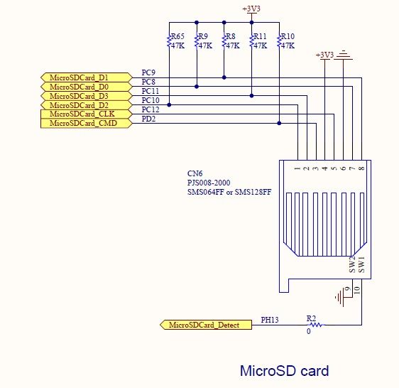

Probably because you have not wired the breakout board in a suitable manner, with pull up resistors. The pin assignments for the SDIO interface are critical, the CARD DETECT is just an available GPIO. Get the pins wrong and the data will be garbled.
The example code from ST assumes the cards support a 4-Bit interface. To debug, read and dump sector/block zero, which should contain a valid MBR (Master Boot Record, Partition Table). Review the SDCard demo example in the firmware libraries.2012-07-09 8:19 AM
i connected my card as shown in the diagram....with all the given pullups...still i am getting the error...nd one thing i want to tell you...my LSE is not running...i dont know why...how i checked it is by checking the signals at PH0 and PH1...no waveform is coming on these pins...it was coming before when is used my board for discovery...bt after one or more resetting the board the LSE is not configuring....help needed
