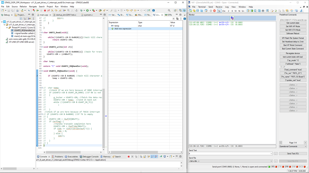

My UART example works very well. But, I want to do with the UART interrupt. Currently it does not work because it always jumps to an infinite loop in the start up assembly code.
Infinite_Loop: // startup_stm32f411retx.s
b Infinite_Loop
Here is my source code. It works great without USART receive interrupt enabled. USART2_IRQHandler is never executed. I have put a breakpoint inside it. Instead, it always jumps to the Infinit_loop line. What did I do wrong? Why your HAL / LL examples work? I looked into the HAL / LL code. It is very similar to my source code.
Thank you for any help you can provide.

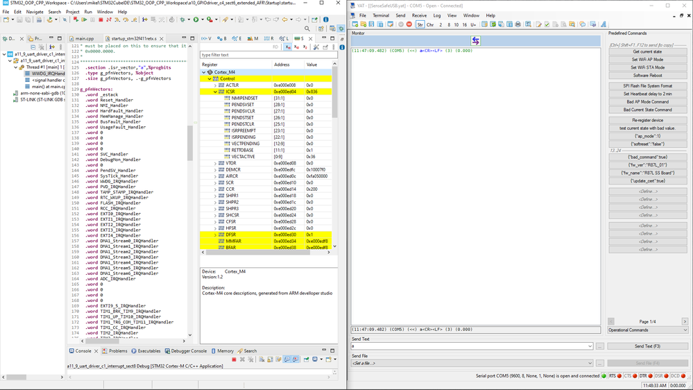

2022-03-27 9:20 AM
When it's in the infinite loop, pause and examine VECTACTIVE field to see which interrupt it's in. If it's USART2_IRQn, then the linker doesn't see your function correctly. C++ or C? Verify vector table entry for that IRQ points to your function and not the default handler.
2022-03-27 11:24 AM
Thank you for guiding me.
VECTACTIVE = 3 (Is it HardFault_Handler?).

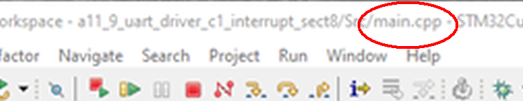

I am using C++, STM32CubeIDE
Version: 1.9.0
Build: 12015_20220302_0855 (UTC)

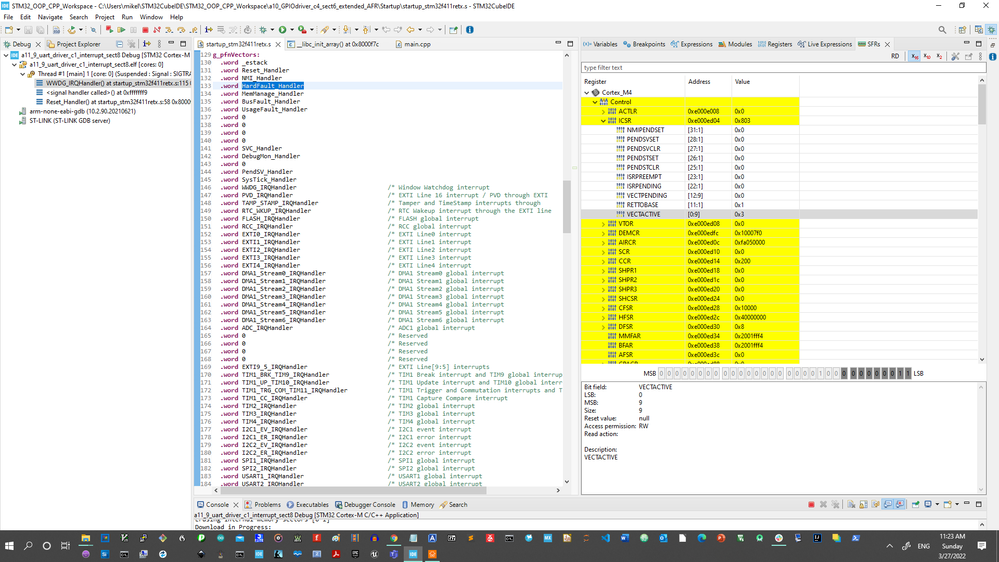

2022-03-27 11:41 AM
Yes, 3 indicates IRQn_Type of -13 which is a hard fault.
I don't think any of the code you've presented would cause a hard fault. But in any case, if it's repeatable, you can step through to see which line causes it. You can also examine the hard fault registers to find the offending instruction.
You can step through at the disassembly level to do individual instructions if necessary.
Looks like CSFR indicates a UNDEFINSTR flag.
If using C++, you need to ensure USART2_IRQHandler has C linkage by using extern C. Unlikely to be the issue here.

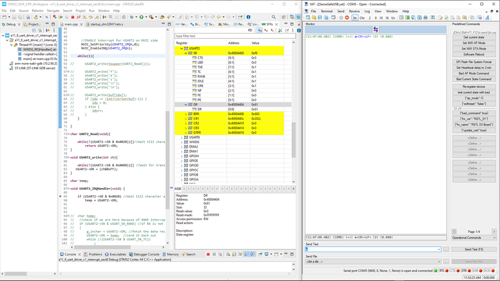

2022-03-27 12:00 PM
It jumps to 54 or 0x36 (USART2_IRQHandler).
184-130 = 54 or 0x36 USART2 IRQ Handler
VECTACTIVE = 0x36
USART2->RXNE flag = 1,USART2->DR= ‘a’
After this, it jumps to the infinite loop. USART2->DR = 'a' (always). It looks that it can't jump to my ISR subroutine for some reason.
