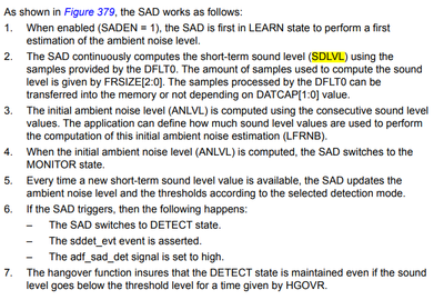

Here an overview of how SAD works:
In the reference manual, you will find more details about the registers as well as SDLVL & ANLVL computation.
