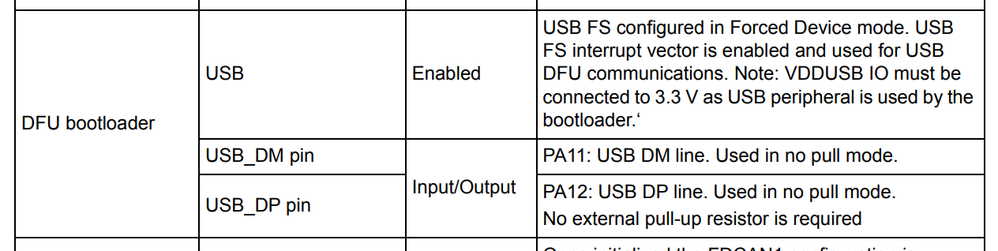

My previous question was how to detect a cable and they said to use a EXTI to receive a VBUS detection. The customer wants to use USB to program a blank device (so nothing configured) and EXTI is a block of interrupts and could be multiple pins. Please provide more details on how the bootloader checks for a USB cable.

I have read AN2606, but it does not tell you how the bootloader detects that a USB cable is detected. We know how to detect a USB cable is connected, but can't find details on how the bootloader recognizes the connection.
