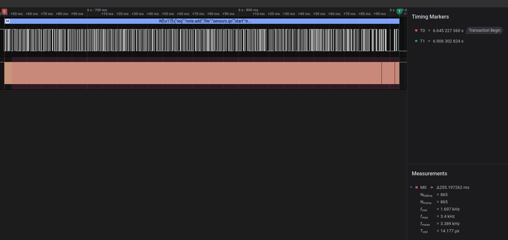

I believe I have found a bug in `HAL_I2C_Master_Transmit`.
The timeout parameter begins counting from the instant the transaction begins, and it doesn't appear that the watchdog is being reset with each incoming byte. Therefore, when you have a long I2C transaction, it will timeout, even if it is working perfectly.
Here is an example with a 250ms timeout:
I would expect the timeout to related to the amount of time the slave device holds the line low, or time between incoming bytes.
