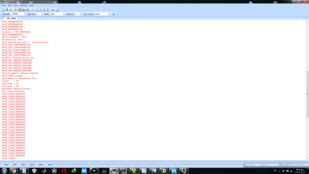

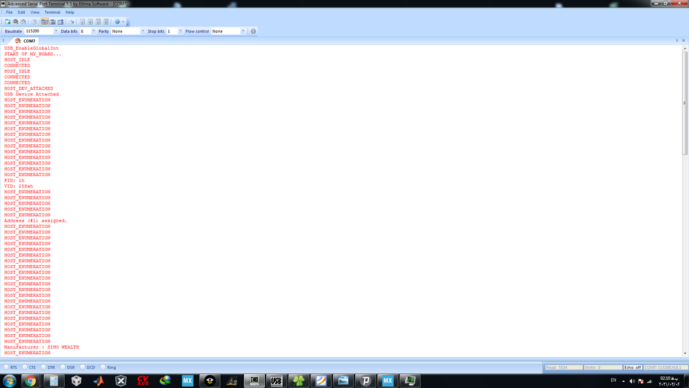

I have problem using STM32 USB Host HID. I`m stuck in the USBH_Process() function in usbh_core.c, or its better to say stuck in USBH_HID_Process() function in usbh_hid.c file. I am trying to connect a USB keyboard to my own designed stm32f407zgt6 board, code is generated through STM32CubeMX v5.2.1 with package software v1.24.2 and I work with IAR IDE v8. I`ve made a project just same as (https://www.youtube.com/watch?v=Co4ChSgVSek), but with different pins pack, every time I connect the keyboard the MCU gets the descriptors, but it never gets data from keyboard. I only used one keyboard model, also searched a lot about the problem. I`ve tried what pavel.a said in (https://community.st.com/s/question/0D50X00009XkZ4KSAV/usb-host), nothing changed, when I printf() the logs on uart, at first I get:
after some "HOST_ENUMERATION"s it recognizes keyboard:

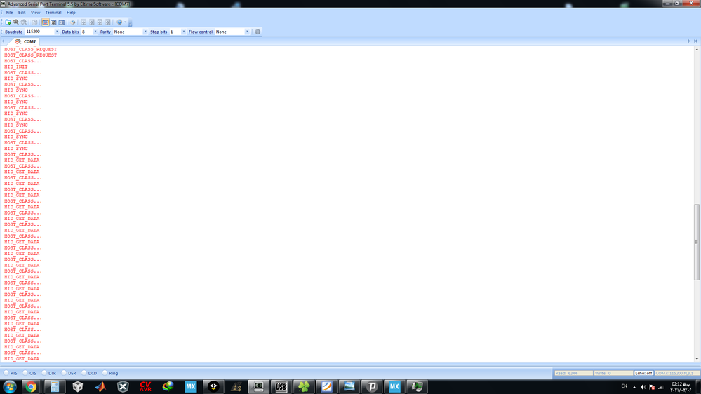

and at last the process goes on like the:
for ever "HOST_CLASS..." from USBH_Process() fuction in usbh_core.c and then "HID_GET_DATA" from USBH_HID_Process() function in usbh_hid.c.

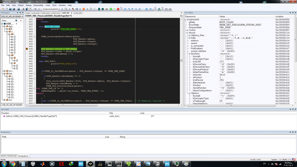

Some place in USBH_HID_Process() function in the "HID_GET_DATA:" part of the switch_case, there is a line "HID_Handle->state = HID_POLL;", but right after this line the "HID_Handle->state" equals to "HID_GET_DATA" (see the forth picture) again very automatically.
So the user defined void USBH_HID_EventCallback(USBH_HandleTypeDef *phost) function is never called to read the data.

Hi, I was facing the same issue. My main loop (firmware is bare-metal programming, no OS) was lasting more than 18ms, whereas USB keyboard requires 10ms polling time (bInterval=0x0A in Endpoint Descriptor). So, as I was calling MX_USB_HOST_Process() inside the loop too late, the routine USBH_HID_SOFProcess() on HID_POLL state executed:
if (HID_Handle->state == HID_POLL)
if ((phost->Timer - HID_Handle->timer) >= HID_Handle->poll)
HID_Handle->state = HID_GET_DATA;
changing HID_Handle->state from HID_POLL to HID_GET_DATA all the time, being ignored the answer received from any PID IN request, although using a logic analyzer I see that the keyboard indeed answered them at 18ms polling interval.
To solve it, I changed if ((phost->Timer - HID_Handle->timer) >= 50) to accept a 50ms polling time for the time being, and now working in polling the keyboard using a timer interrupt. I'm not sure to being able to reduce main loop under 10ms or 8ms as preferred because HID standard mentions that usually keyboards are poll at 125Hz (8ms).
In conclusion, be aware that if you are calling MX_USB_HOST_Process() (i.e. USBH_Process(&hUsbHostFS)) later than the required poll interval specified by the USB keyboard in its endpoint descriptor, HAL USB host library will not trigger USBH_HID_EventCallback function.
