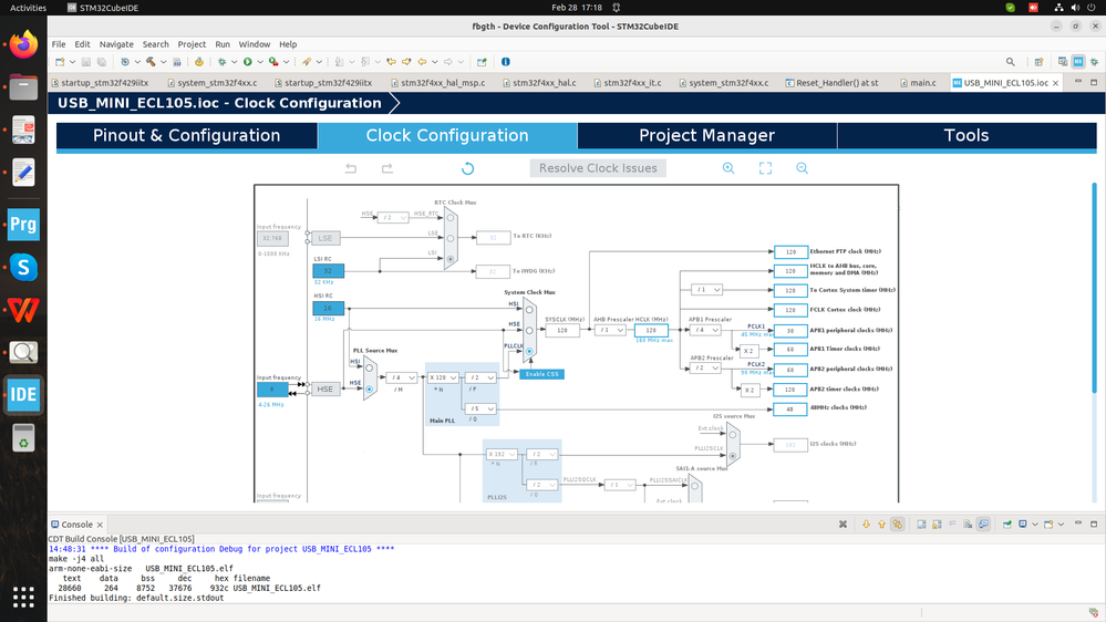

I have checked the clocking too , it is correct. not working as in PC is not able to recognize the USB and i have also tried mass storage with USB but it is still not helping me enough.
I am attaching CLK config for your reference.

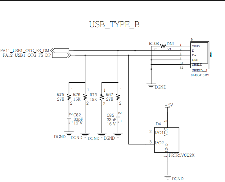

All other peripheral works fine only USB does not work . I attached schematic of USB also please go through it once

Check the clock source. On Nucleo, it's external 8 MHz generator (NOT crystal by default), don't know about your board.
