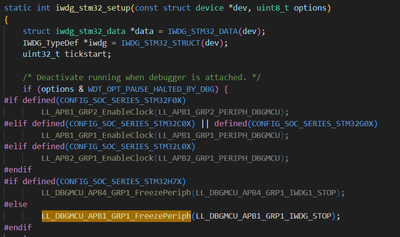

2025-05-30 6:13 AM
To halt IWDG during debug, set DBG_IWDG_STOP in DBGMCU_APB1LFZR.
