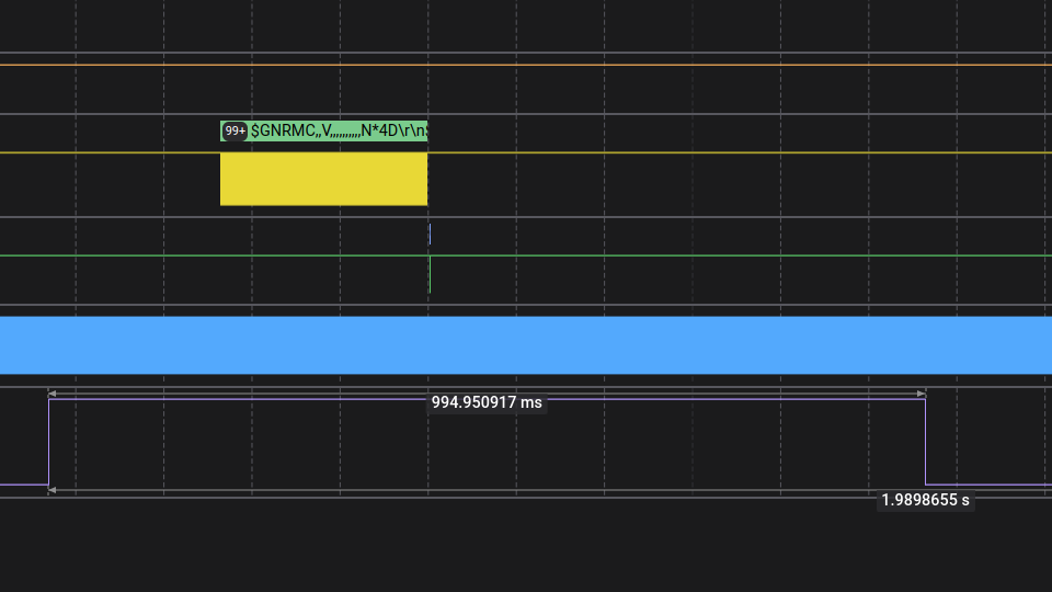

}should wait 1 second, toggle a pin again and again. With a single task, it looks ok:
On this graph the bottom pin toggles every second.
The blue bar is in fact a toggle on a pin in the IdleHook function which means that the MCU does nothing nearly all the time.

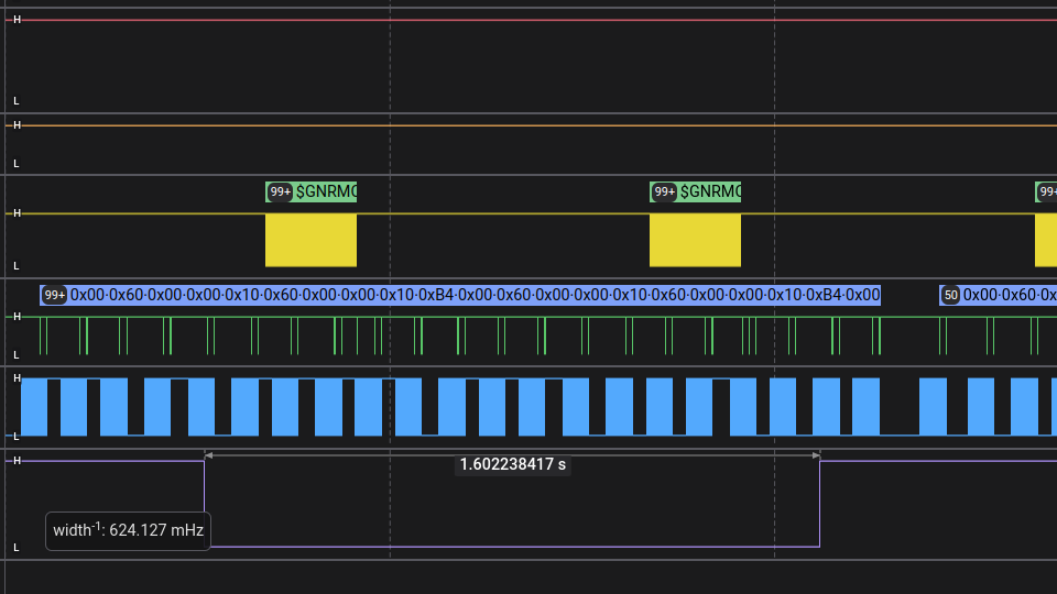

Now, if I add a second task that does some interesting job, with the same priority (1), here's the result:
The delay function result is 1.6s instead of 1s. The 0.6 difference is equal to the sum of
the duration of all the moments the mcu is not idle.
