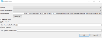

 - I set the Boot_XIP.hex in to the debugger configuration (In the readme both Boot_XIP.hex and Boot_XIP.elf are mentioned but only Boot_XIP.hex exists in STM32Cube_FW_H7RS_V1.1.0\Projects\NUCLEO-H7S3L8\Templates\Template_XIP\Binary ) . And move it to the bottom

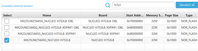

- I add the MX25UW25645G_STM32H7R38-NUCLEO.stldr as external loader

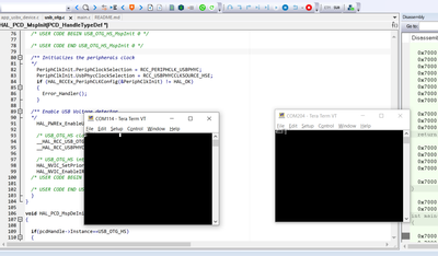

After starting the debugging, the code gets stuck at USB_CoreReset() while waiting for the USBx->GRSTCTL & USB_OTG_GRSTCTL_CSRST to clear.

  • An other Thread recomends setting __HAL_RCC_SYSCFG_CLK_ENABLE(); in HAL_PCD_MspInit() but this macro does not exist in the stm32h7rsxx_hal_rcc.h

I set the loader to MX25UW25645G_STM32H7S3L8-NUCLEO.stldr
Note: The MX25UW25645G_STM32H7R38-NUCLEO.stldr mentioned in the README actually does not exist on my system - i already had the H7S3L8 variant selected and just reported the wrong one.

The selection of the Boot_XIP:
