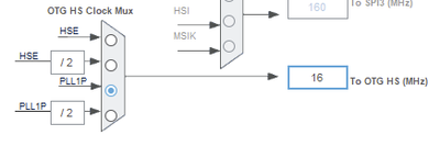

I was able to fix it by switching OTG HS Clock Mux from HSE / 2 (my crystal is 32 MHz) to PLL1P:
System Clock Mux is set to PLLCLK, PLL1 Source Mux is HSE.
With PLL1P, USB_CoreReset() returns successfully. With HSE / 2 - it does not.
If I switch OTG PHY ref clock to 32 MHz and use HSE as source, it also works correctly. So the problem appears to be with the HSE / 2 setting only.
