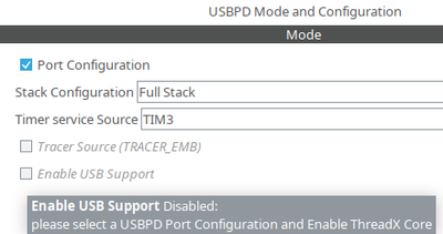

I have found out why there is no usbpd_usb_if.c/.h files generated because we need to activate "Enable USB Support" inside the USBPD configuration tab:
When deactivating FreeRTOS and enabling AzureOS and USB Support, I can find the files. But of course, when you activate AzureOs, USBX isn't in Stand-alone mode anymore. In the generated files (usbpd_usb_if.c) we can find some related code :
tx_queue_send(&ux_app_MsgQueue_UCPD, &USB_Host_State_Msg, TX_WAIT_FOREVER) != TX_SUCCESSWhich use a queue "ux_app_MsgQueue_UCPD" defined in the USBX stack newly re-generated. And is only usable with AzureOs.
