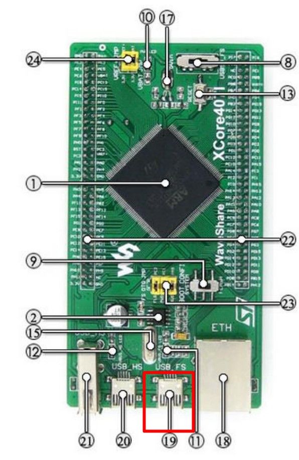

Hi how can i use UART Pins via USB FS. I am currently using the USB TO UART connector on my devboard but how can i use the USB FS connection to make uart pins working?

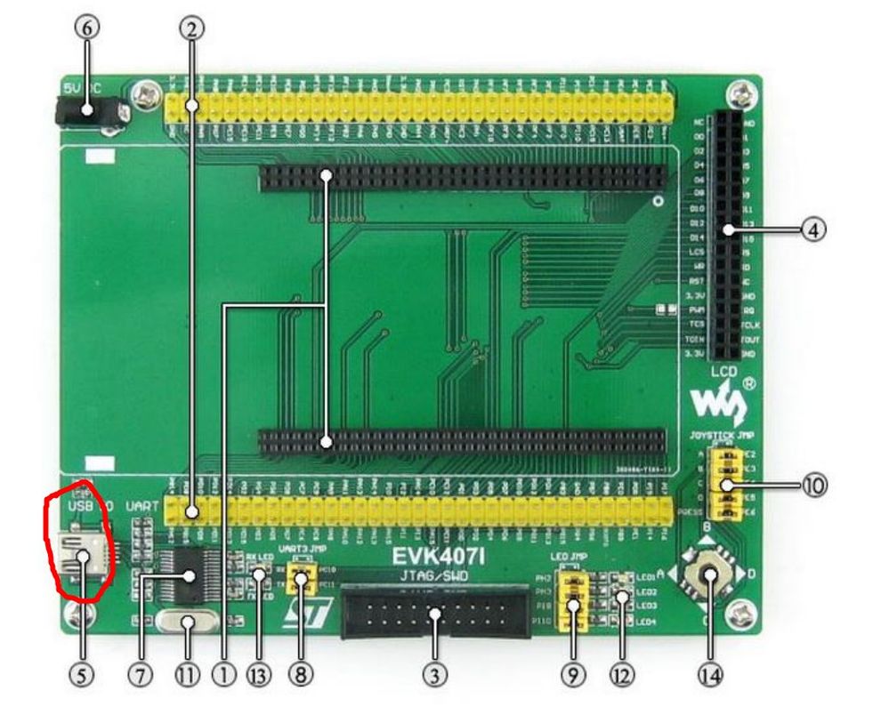

I want to use uart3 PC10 and PC11 Pins but its not working with the baudrate if i connect usb fs but its working with usb to uart why?
Below pictures of the mcu and the dev board i marked the connections:

If you want to use PC10 and PC11 to connect another mcu through UART, you need to disconnect whatever is connected to those two pins on the board. It appears, that you need to remove the two jumpers marked PC10 and PC11. Look at the schematics of the board.

i removed the jumper and connected the USB Cable to USB FS and the micro chip to pc10 and pc11 but it doesn't work.

Okay, so you need to implement USB Device CDC class in the 'F407, and link that to USART3.
