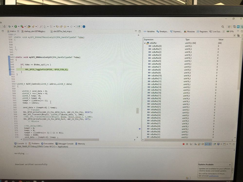

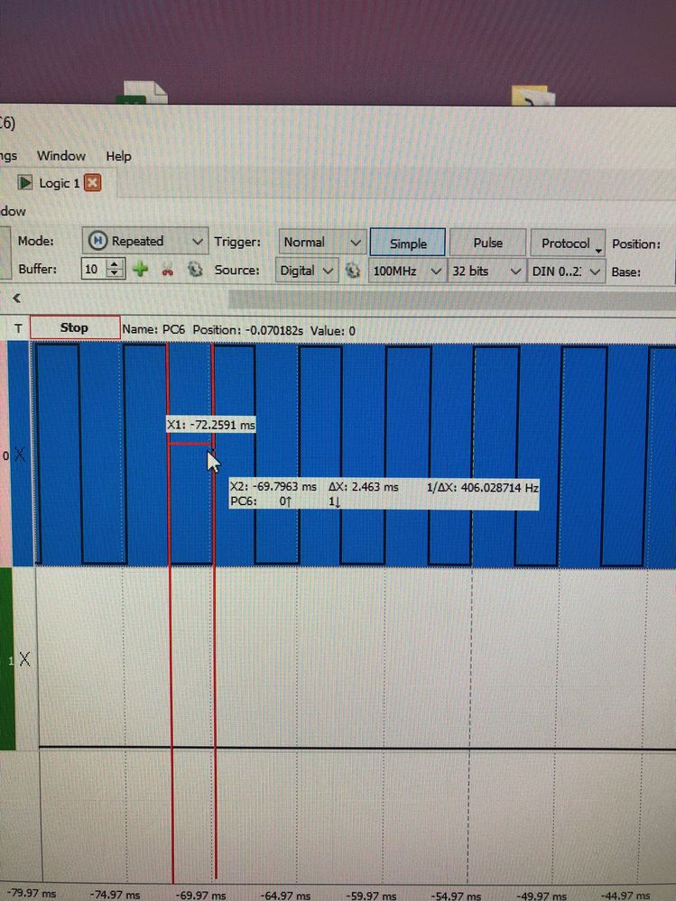

I want to share my related code and photo here. The program runs on an STM32F746 Nucleo Board. It uses timer 2 to trigger DMA1 stream 0 causing fixed-length transmission of data via SPI 1 to an external ADC without interrupts on the transmission side. Timer 2 confüguration is settled at 25600Hz this is used as a sample rate. Therefore data must be received with SPI3 every 25600Hz. I created a test pin to understand that the sampling process is finished. The sample size is 64. The complete time is 64 x 1/25600 = 400Hz. I can see this period with diligent oscilloscope but the received data is empty. Can you show me where I'm doing wrong?

Since mySPI_DMAReceiveCplt is being called, something is working right.
How do you know 0 isn't the correct data in this case? Initialize it to something unique (perhaps a ramp, 0, 1, 2, 3, etc.) and see if it gets changed. (Even if 0 isn't the expected data, it could still be due to a pin misconfigured or disconnected or otherwise.)
Could also define rxBuffer as volatile, but I doubt that's it.
2023-10-03 7:28 AM
I defined buffer as volatile but there is no change. I can see debugging mode.

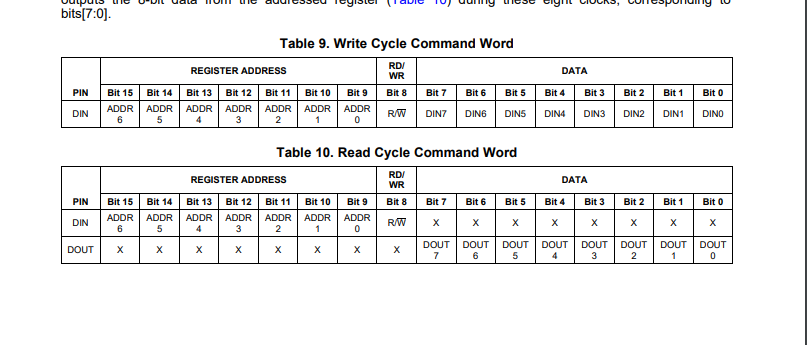

first I configurated external adc register wrote and read the same register then set it to auto mode and started the sample with spi3.In addition ı don't use nss pin. I use software nss . Cs pin is already low(active).

// This case is triggered the dma , it is correct because we can see the image that 405Hz toggle pin.

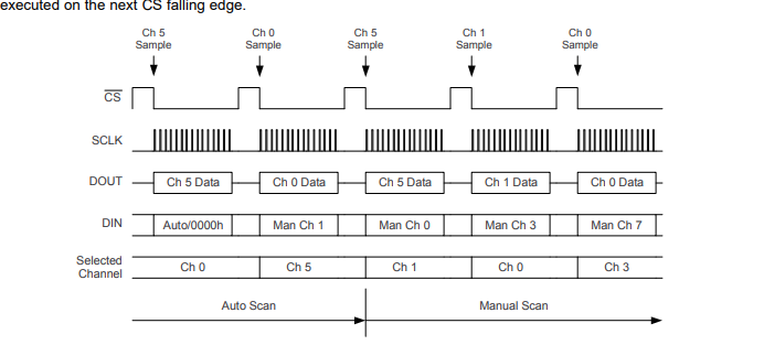

The error comes from triggering the SPI NSS pin.
First, I performed Hardware output Nss and saw that it did not write or read the register return value was 0. After Hardware I canceled NSS and turned it on and off with software. I wrote to the registers and read the correct data, but I could not read adc value. The problem right now is that I need to turn the CS pin on and off while receiving data via dma.
2023-10-04 5:13 AM
How? Show some timing diagram.

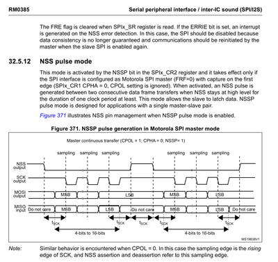

Check out NSS pulse mode:
Note that CPHA must be 0. Check with the slave's datasheet if this is viable.
I don't use Cube/CubeMX so don't know how to click this in CubeMX or what Cube/HAL incantations lead to this being properly used.
