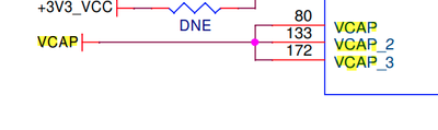

The caps on the HSE crystal should be connected to ground.
VCAP should have capacitors to ground, don't see VCAP connected anywhere else in the schematic.

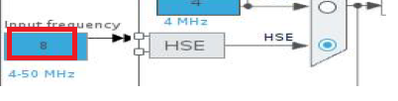

What is the system clock frequency? the voltage scale configured? number of Flash wait states? Power in SMPS or LDO mode?
Please provide us with your schematics (HSE part) + CubeMx file?

I am using LDO mode. I am running the microcontroller on maximum frequency, 480MHz. For external clock, I have tried with both 8MHz & 25MHz crystal. The voltage scaling is 0. And the flash wait state is 4. The remaining code is auto generated using STM32CubeIDE.

That's normal, in the schematics you have 25MHz as external crystal and your software sets it to 8Mhz so the MCU is overclocked.
You have to modify the value to 25 instead of 8.

So I have tried both 25MHz & 8MHz with the respective configurations but the issue was still there. Currently I have mounted 8MHz crystal.
The problem I am facing is, whenever I use HSE for configuring PLL the below issue occurs. Break at address "0xa05f0000" with no debug information available, or outside of program code. And the program especially Cortex-M4 stops.

@TDK thank you for pointing this out. I didn't notice this.
@HDesa.1 please review your schematics and refer to the AN4938 You need to have capacitors on VCAP pins.
You can also inspire from STM32H743_EVAL schematics
