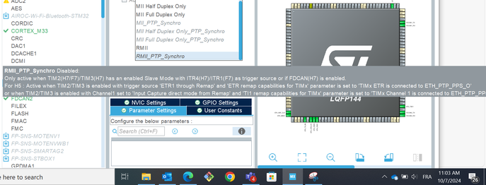

I had some issues configuring H573 with CubeMX.
When I configure TIM2 or TIM3 according to the instructions of RMII_PTP_Synchro in CubeMX I cannot enable the RMII PTP functionality.
And when looking at RM0481 it seems that the description of the relationship between these two timers and ETH MAC is a bit vague.
What configuration is required to enable RMII_PTP_Synchro on H573?

There are two ways to activate RMII_PTP_Synchro for the H5: First, by enabling TIM2 and TIM3 with the trigger source set to 'ETH1 through Remap' and configuring the ETR remap capabilities for TIM2 to "TIM2 ETR is connected to ETH_PTP_PPS_O" and for TIM3 to "TIM3 ETR is connected to ETH_PTP_PPS_O".
Alternatively, you can enable TIM2 and TIM3 with Channel 1 set to 'Input Capture Direct Mode from Remap' and set the TI1 remap capabilities for TIM2 to "TIM2 Channel 1 is connected to ETH_PTP_PPS_O" and for TIM3 to "TIM3 Channel 1 is connected to ETH_PTP_PPS_O".

I enabled Trustzone when I created the project and followed the recommended configuration in the software, but RMII_PTP_Synchro is still not selectable.
am I missing something or is the feature not optional when Trustzone is enabled?

Hi !
I'm still having this issue with STM32H563RGT6.
In CubeMX, I've enabled TIM2 as slave (External Clock Mode 1), Trigger Source as "ETR1 through Remap", Channel 1 as "Input Capture Direct mode from Remap".
ETR remap capabilities for TIM2 = "TIM2 ETR is connected to ETH_PPS".
Input Capture channel 1 => TI1 remap capabilities for TIM2 = "TIM 2 Channel 1 is connected to ETH_PPS".
(See attached screenshots for details)
However, RMII_PTP_Synchro is still greyed out.
I've tried with and without Trustzone, but still have the same problem.
Is there anything that I'm doing wrong ? Do you have any update on this ?
