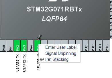

If you use STM32CubeIDE or STM32CubeMX, you can use Enter User Label to name the pin. In this case, PA5 is named LED_GREEN.
When you generate the code, it'll create the Port and pin defines in main.h
/* Private defines -----------------------------------------------------------*/
#define MCO_Pin GPIO_PIN_0
#define MCO_GPIO_Port GPIOF
#define LED_GREEN_Pin GPIO_PIN_5
#define LED_GREEN_GPIO_Port GPIOA
#define TMS_Pin GPIO_PIN_13
#define TMS_GPIO_Port GPIOA
#define TCK_Pin GPIO_PIN_14
#define TCK_GPIO_Port GPIOA
