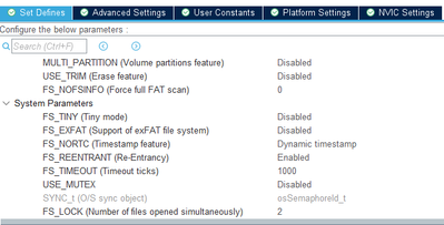

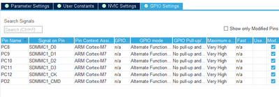

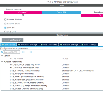

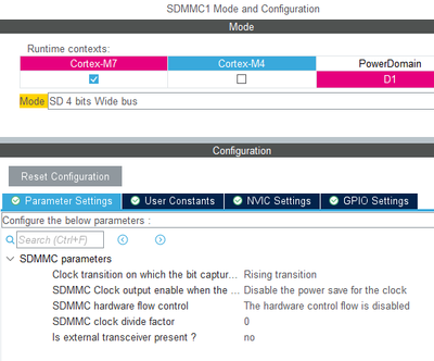

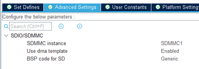

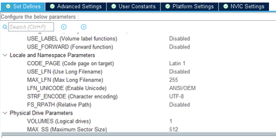

Here my configuration.

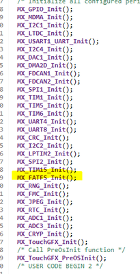

I notice in the main that there is FATFS initialization
but I don't find a call to MX_SDMMC1_SD_Init.

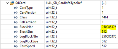

If I force this call after FATFS initlization the code run in ErrorHandler, but if I inpect hsd1.SdCard struct I see that card property are read correctly (I believe).
BlockSize x BlockNbr = 128G !! OK

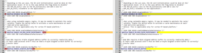

1. Replace 0x00 with SD_PRESENT line 297 in bsp_driver_sd.c

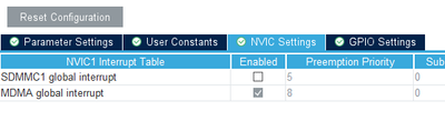

2. Enable SDMMC1 global interrupt

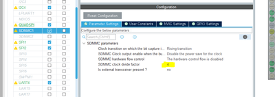

3. Set SDMMC clock divide factor to 4

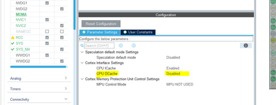

4. Disable CPU DCache

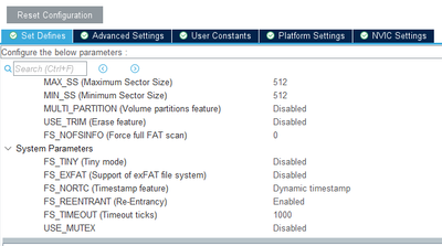

5. Enable this defines in /CM7/FATFS/Target/sd_diskio.c
With this modifications mount, read and write to uSD work.
I would want to lay the CPU DCache Enabled because to being not enabled let me lose computation power.
If someone has some suggestion I will appreciate.

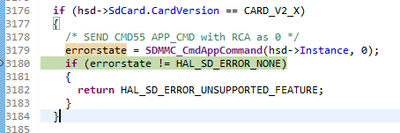

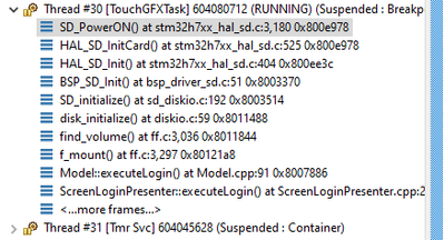

I inspect the code step By step and I notice that my SD card is CARD_V2_X and that code seems go properly until it reaches this instruction in stm32h7xx_hal_sd.c
error state is 4 (HAL_SD_ERROR_CMD_RSP_TIMEOUT) that is different from HAL_SD_ERROR_NONE and so it returns UNSUPPORTED_FEATURE.
Here the stack

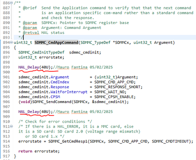

I inspect SDMMC_CmdAppCommand ... I've tried to add some HAL_Delay (commented Mauro Fantina) but the problem still remain
